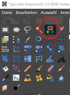

Turnig a layer is that symbol:
File comment: Turn layer
On the layer with the heart: Right mouse click, choose "add Alpha channel". By default, the layer don't hav an alpha channel. The alpha value describes the value of transparency. Now you have to get rid of the white color in your heart layer.
Use that symbol:
File comment: select by color
and select the white color in your heart layer. A line with "walking ants" appears around that layer. Press the "Delete" Button on your keyboard. The white Color disappears. You will not see it, because the background layer is white, too. But if you move your layer with the heart over the layer with the flower, you will see the success.
