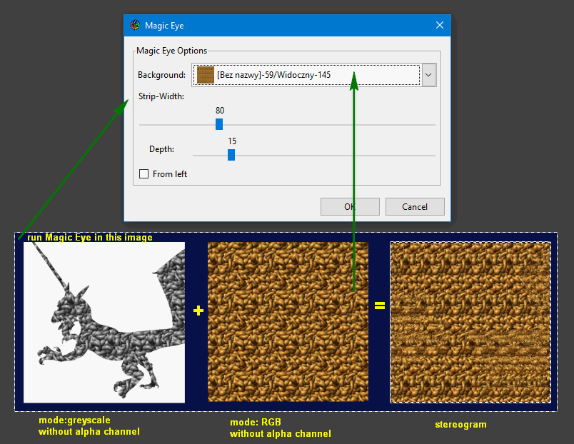

At Lylejk's request and for fun I compiled Magic Eye for Gimp-2.10.
Sources magiceye-0.4.0.tar.gz: http://schumaml.gmxhome.de/downloads/gimp/sources/

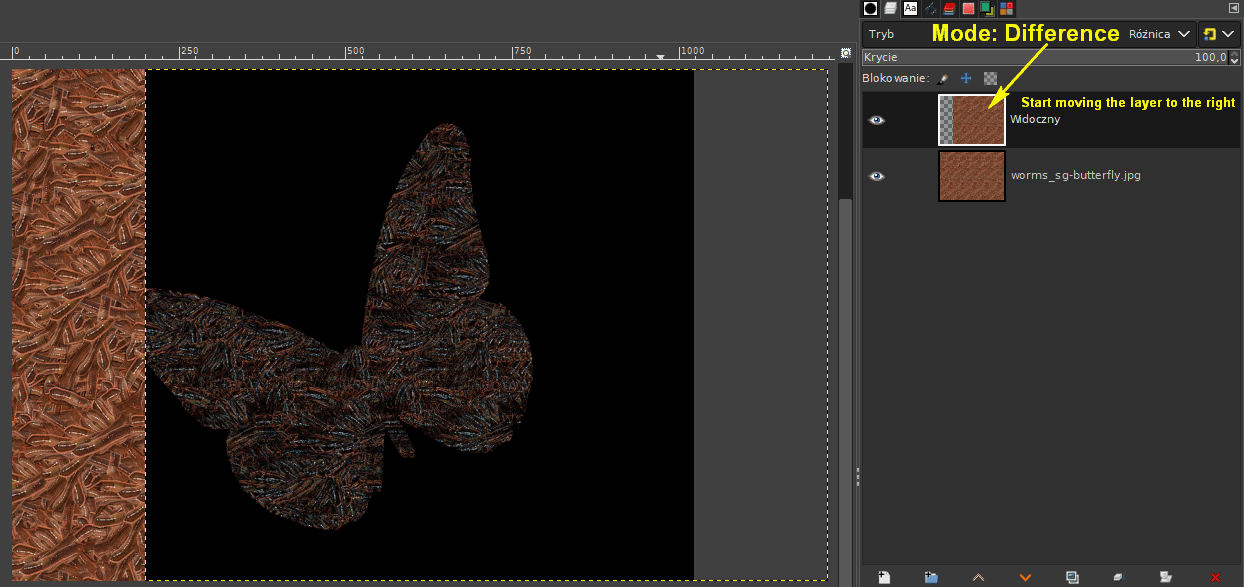

Unfortunately - I can't see the source image but there is a way:
https://georgik.rocks/how-to-decode-stereogram-by-gimp/
