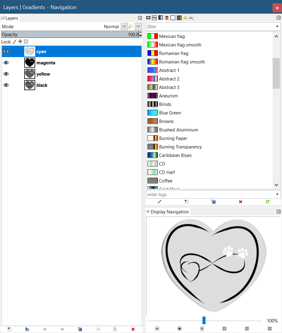

You could provide 4 separate masks (one for each of the primary colors in CMYK space) to your printer and see if that would be good enough. Easy to do so in GIMP. :)

You can do so yourself, gimper66; not hard at all; built into GIMP's color support menu:

yes ok, but what can i do with this result
 Post subject: Re: COLOR CONVERTED TO CMYK
PostPosted: Tue Nov 24, 2020 9:39 am  (#11)
Posts: 12845
Each channel can then be exported to a file and send those files to the printer to make plates. :)
