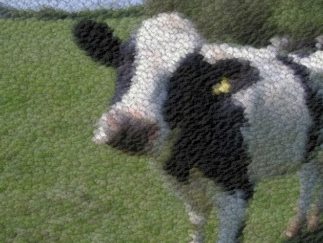

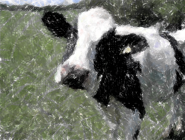

I created a new Gimpressionist brush and used it first.
Then i opened the image in Impressionist (8bf), and added small crayon strokes.
Then i put the image through Rodilius (lighter and saturation for channel)
Results
 Post subject: Re: Utilizing Fenceposts new brush
PostPosted: Wed Nov 16, 2011 3:00 pm  (#2)
Rod, that looks just like some one painted it. Most cool. :bigthup

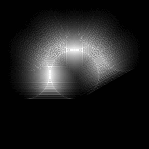

The best way to create a bump-map of Rodilius's effect is to create just the effect on a black bg with a white circle.
Rodilius utilizes the L channel to motion blur.
Example...you can grab this one and save it as Rodilius.pgm file if you like.All the work of composing, and decomposing is done.
You see that is why the Rodilius effect is so hard to mimic in Gimp itself. :)
It's immensely difficult to duplicate using Gimps motion blur tool with a actual image.
Just a black bg with a white dot, well that is a simple matter all together.
The new Rodilius brush in Gimpressionist
As you can see the brush doesn't look all that nice with Gimpressionist applications. :)

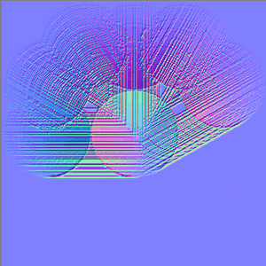

Now what i could do is open that png in Filter Forge and create any map you want.
Would you like me to do that?
PostPosted: Wed Nov 16, 2011 6:21 pm  (#6)
Sure, if you don't mind. I thought the maps were more singular stroked in shape (it looks a lot differently than what I was expecting, but the result in G'MIC is terrific, btw.)
PostPosted: Wed Nov 16, 2011 6:32 pm  (#7)
Posts: 16213

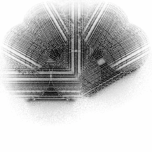

Just tell me if you need any more different types of maps Mahvin.
Bump
Ambient Occlusion
Normal
