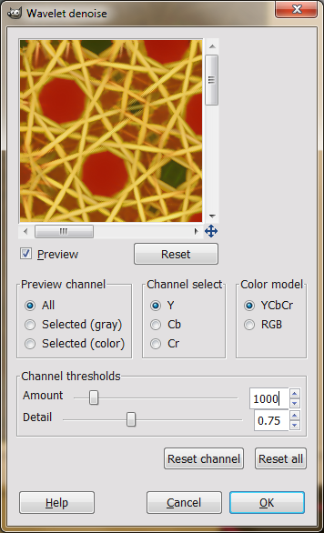

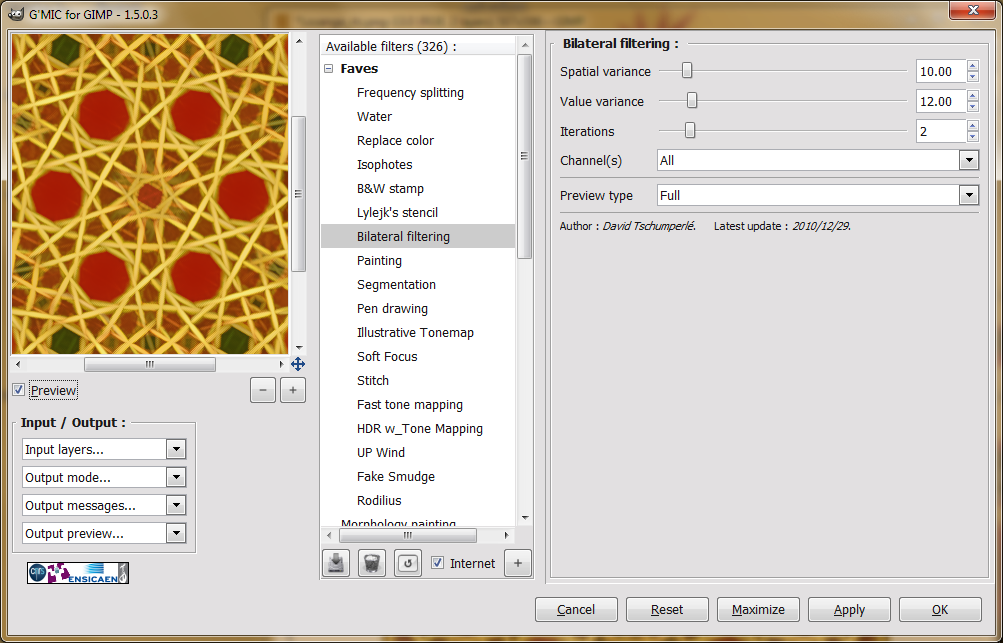

Run Rodilius, dup, run G'MIC Bilateral filter followed by Wavelet Denoise (2 to 3 times here using ctrl-F) and merge down. The part in red is what I call Illustration Amplication. Set this highpass like result to Grain Merge and dup til happy. I do this quite often and with some additional tricks, you can really get a good Norman Rockwell render with this. :)
