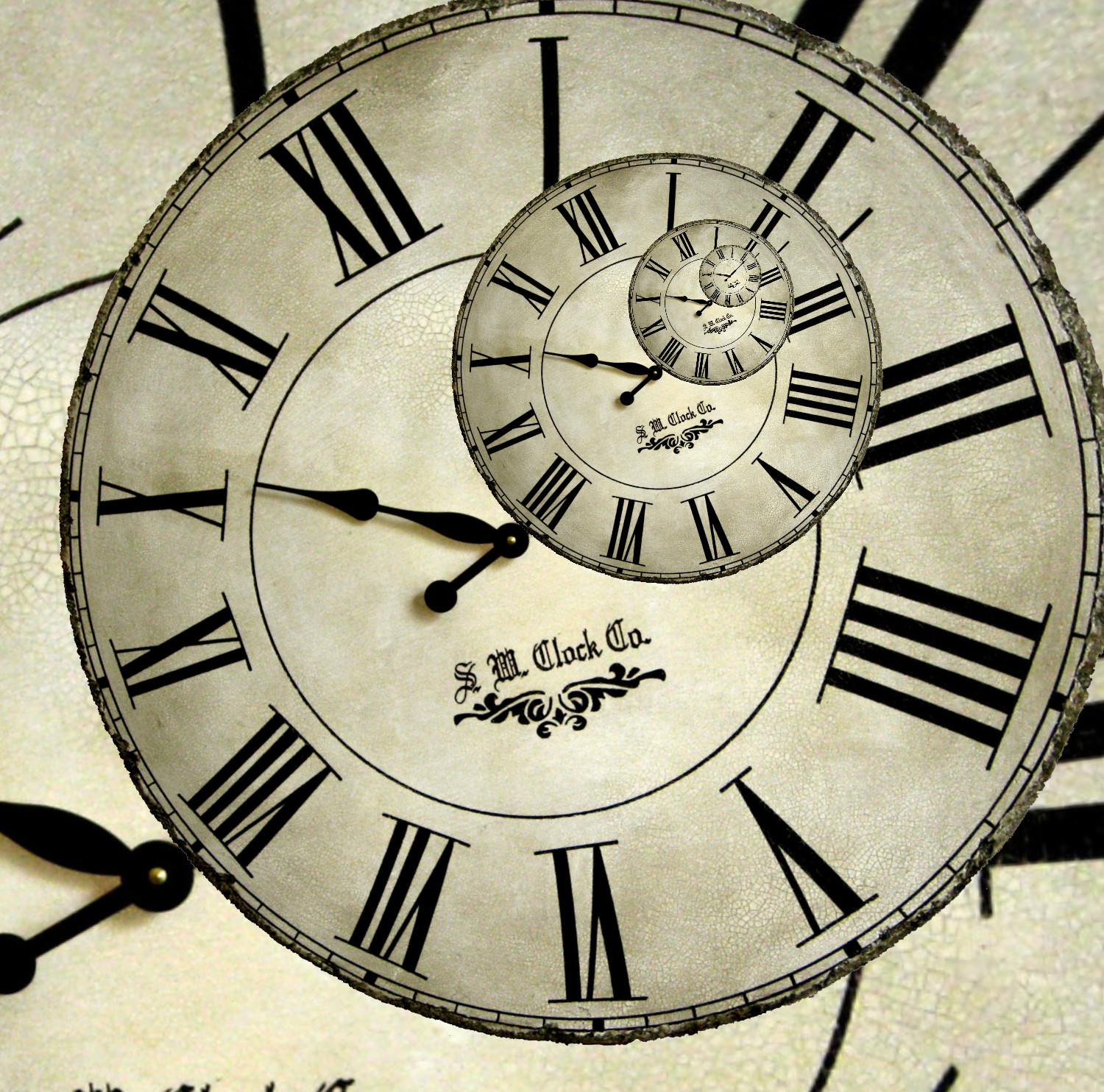

racer-x got me thinking about Droste animations after he uploaded a great example. I discovered something interesting that I didn't know......
Once you have done your Droste image you just need to rotate it and Droste does the rest. In this animation there is no zoom.
It's an astrological clock (Merry Xmas-Solstice).
I rotated it with G'Mic>Garage Coders Smart Rotation. How many degrees is up to you but you duplicate the last rotated layer and apply the same degrees to that before duplicating it and adding those degrees again. I used 12 degrees X 30 layers = 360 degrees.

Interesting, MathMap 'Animated Droste Whip' is just 'Continuous Droste' with another name.
It can render all frames in a single operation (not one frame at a time). I don't think that has been implemented in G'Mic Continuous Droste.
Also, you don't need to use "all layers to image size" or downscaling as Nidhogg recommends.
Prague Astronomical Clock With Droste Effect
If you use Droste Whip then G'Mic Continuous Droste default settings are a good place to start. 'External transparency' must be ticked and
I only changed 'inner radius' and 'start level' a bit. Test with the animation slider. I used racer-x's FFMPEG command to get under the Gimp Chat 5.2Mb upload limit.

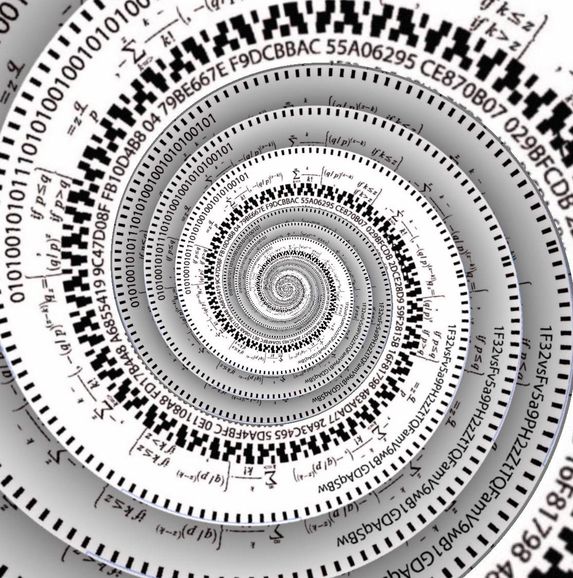

Nidhogg wrote:
Droste in fun.
G´mic continuous droste, rotate nLayer: 5 degrees 72 copies, all layers to image size.
Rename layers: (40ms), downscaled.
Something I was not aware of, you need to use "all layers to image size" before downscaling,
or it will shake weirdly and not look good. I guess it has something to do with the rotated layers going over the layer boundaries?
I'm new to GIMP and I downloaded it and was able to create some neat droste stills, but I would love to do an animation that loops infinitely like this.
I didn't see an "nLayer" setting in the G'MIC droste filter options - where can I find this?
Or is the instruction simply to create 72 identical layers, rotate each layer by 5 degrees and animate?

I think Nidhogg duplicated the original layer 72 times and then used Continuous Droste to rotate each layer 5 degrees more than the previous one (72 X 5 = 360) His series would have been 0,5,10,15,20 etc.
Your image is worth rotating but make sure it has equal height and width. If you are making an animated GIF then it's too big @ 1115px.
The advantage of MathMap is you can do it in one operation but MathMap has no windows support at present.

Yes my spiral had 72 layers (using 5 degree turns) which makes it smooth enough.
The image was done with Gmic droste, but the animation was done using "rotate nLayer" script.
It's a Gimp 2.8 script, I haven't used it on 2.10 yet, but it can be fixed for 2.10.
Wouldn't go higher than around 300x300 pixels with a gif animation that has lot of layers.
But it depends on your computer specs and other things.
Attached the 2.8 version of rotate nLayer script and Tin Tan's rename layers for animation plug-in.
I had to zip it, did not accept .py upload.
Don't know the max upload limit so I made the gif under 4mb.
1. Cropped to 1000x1000 square (your image wasn't square)
2. Scaled to 400x400
3. Rotate nLayer with the settings below.
4. Cropped to 240x240
5. Used Tin Tan's "rename layers for animation" to speed the animation (35ms per frame)
6. Filters/animation/optimize for gif.
7. Export as gif, remember to save as animation.
