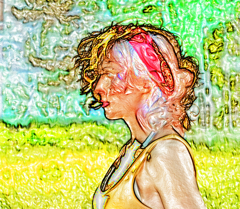

- creating a "bas-relief-like" image
or
- ..a seamless pattern

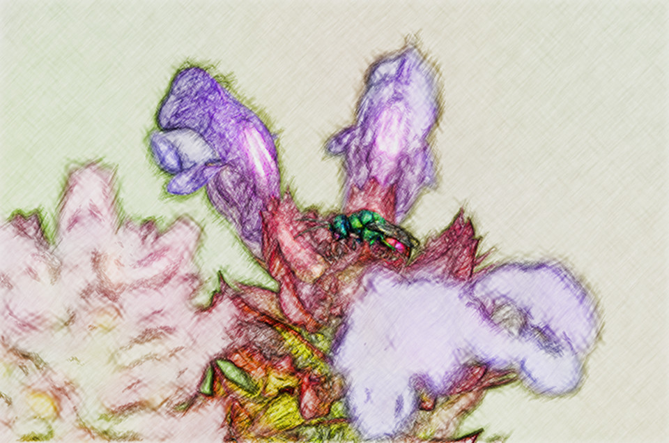

something different
experimenting G'MIC sketching filters
from
to
ColourSketchDraw moritzburg-84299_960_720 non stretched .jpg [ 249.92 KiB | Viewed 2271 times ]
or
ColourSketchDraw moritzburg-84299_960_720 stretched .jpg [ 270.64 KiB | Viewed 2271 times ]

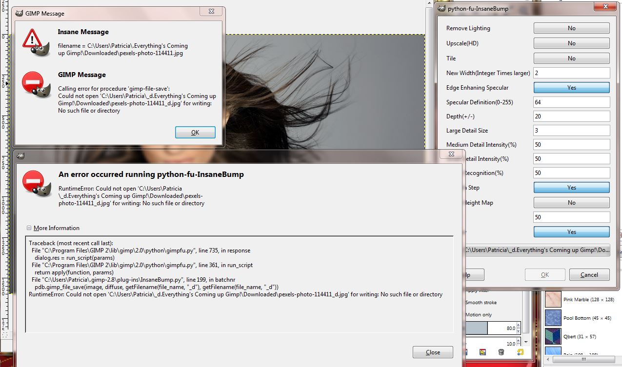

Dinasset: I did not reinstall the normal map before putting in your version of insane.py. These errors are the same as when I installed normal map in the various places stated previously.

the folder under Patricia starts with a dot? Can't be
Look at the first message
Is it really the path to your file? ../Patricia/.Everything ?

create a new folder under Patricia, name it TESTINSANE, put your source image in there and try again
 Post subject: Re: my plays
PostPosted: Wed Aug 31, 2016 12:25 pm  (#31)
after you have the image in the new folder, close and restart Gimp, otherwise the previous path is still in memory...
then open the image from the new folder and run Insane
PostPosted: Wed Aug 31, 2016 12:45 pm  (#32)
note: Insane plug-in makes use of "gimp_image_get_filename".
This procedure returns the specified image's filename in the filesystem encoding. The image has a filename only if it was loaded or imported from a file or has since been saved or exported. Otherwise, this function returns %NULL
Thus use an image you saved in a folder.
Doing what I said, it's OK (taking the image and copying it into the new folder created)

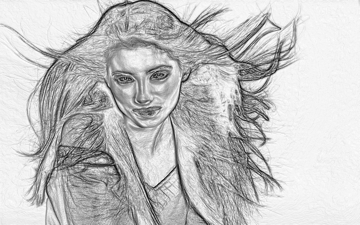

Dinasset: There was a dot. I have no idea how long it has been there as I set up those directories a long time ago. What a Typo!! I followed your instructions and this is the result.
Original:
Result:
Now I must figure out how to control the result as your's was not black & white sketches.
I am full of problems today! Now that I have the dots out of the folder name, I cannot get GimpChat to realize that. When I Browse to upload an image, it shows the old folders with the dots even though they don't exist any more. I have closed all the programs and shut down the computer completely but it has not changed anything. Any ideas? Everything is correct in Windows Explorer.

for colour, just move the original on top and set it to Color (or something similar, GrainMerge, fpr instance).
About Gimp-chat remembering the dots, I do not know, maybe it is an ...elephant with a long-lasting memory!
