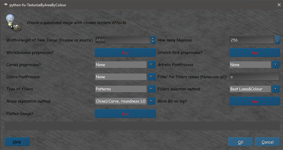

Does it run png, jpg as patterns also? Or do they have to be .pat files?
Because i set it at None and i get the error with 36 patterns/nuances.
I ran it with these values. I put the letter "o" in the filter names area.
I got this.
It seems the filter names area is very picky. :)

If i set it to NONE and 256 i get the error.

animicule i have a special gimpfu.py file.
256 nuances - best color - letter o for filter filler names.

there should be an invalid pattern in your system
the filter accepts any pattern
statement to load them says "(np, LPATT) = pdb.gimp_patterns_get_list (names_filter)"
the only discriminant being the substring entered in the parameter (in "None" it is converted to "")
could you check your patterns list?

according to your last successful outcome, the invalid pattern does not contain the letter "o"

Just tried "alpha" as filler name filter and 256 nuances and got a result.
Does the filter recognize .bmp files?

 Post subject: Re: TexturizeByAreaByColour (new edition published)
PostPosted: Tue Oct 25, 2016 11:20 am  (#220)
back home
it seems that the pattern which immediately follows the "Clipboard" does cause the error
can you check?
