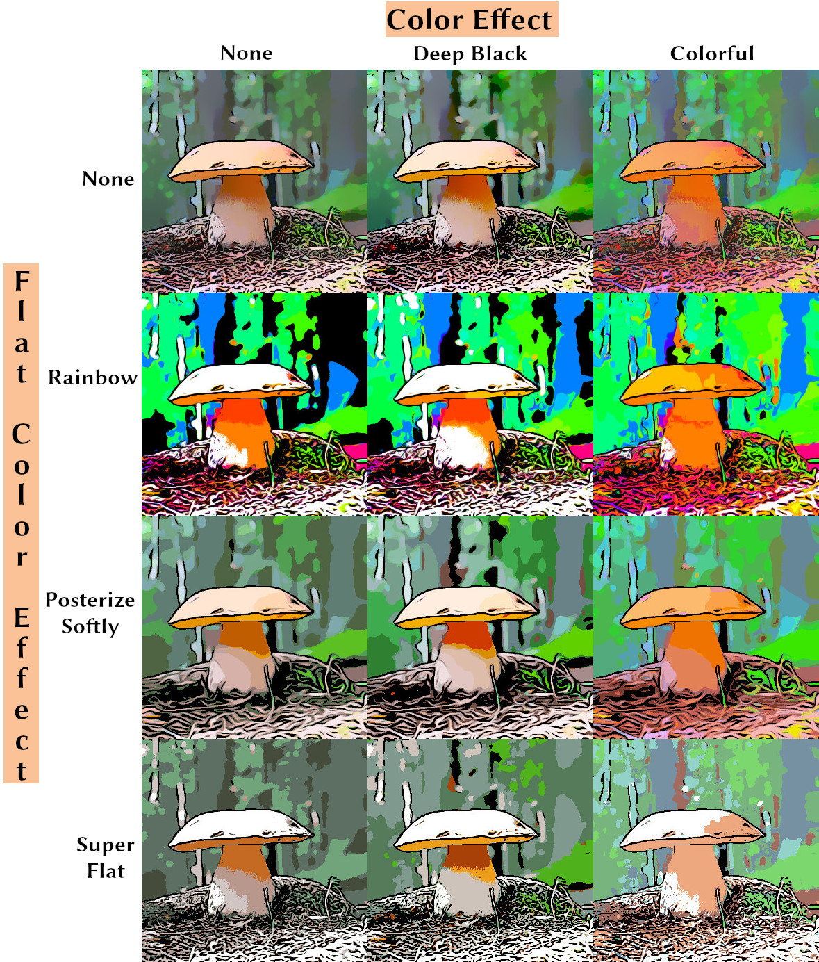

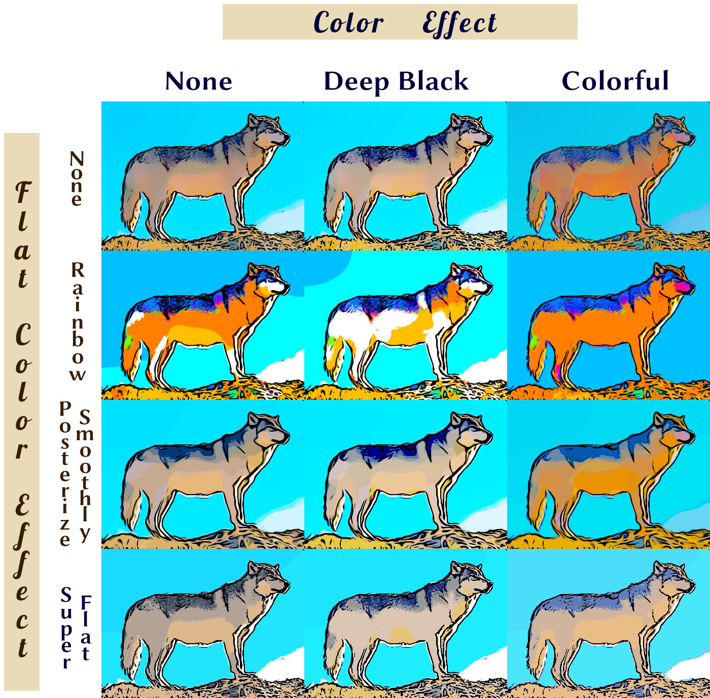

The G'Mic filter "Comic Book" now has new additional effects (Hit "Ctrl-R" on G'Mic window to get them).
  • Color Effect: Deep Black, Colorful.
  • Flat Color Effect: Rainbow, Hard Rainbow, Posterize Softly, Super Flat.
  • Relief Effect: Groove, Bump.
The "Colors to Black or White" checkbox has become a dropdown list: Soft Threshold, Threshold with Soft Antialias, Lines and Black.
The old checked "Colors to Black or White" is equivalent to the new "Colors to Black or White = Soft Threshold" (as in this post of Jappaloe63).
"Lines and Black" is the same effect as in this post.
A "Final Antialias" checkbox is added.
Here are a few examples of "Color Effect" and "Flat Color Effect":
King_Boletus__Boletus_edulis_small_addiEffect_compare2.jpg [ 832.08 KiB | Viewed 3651 times ]
Have fun!
