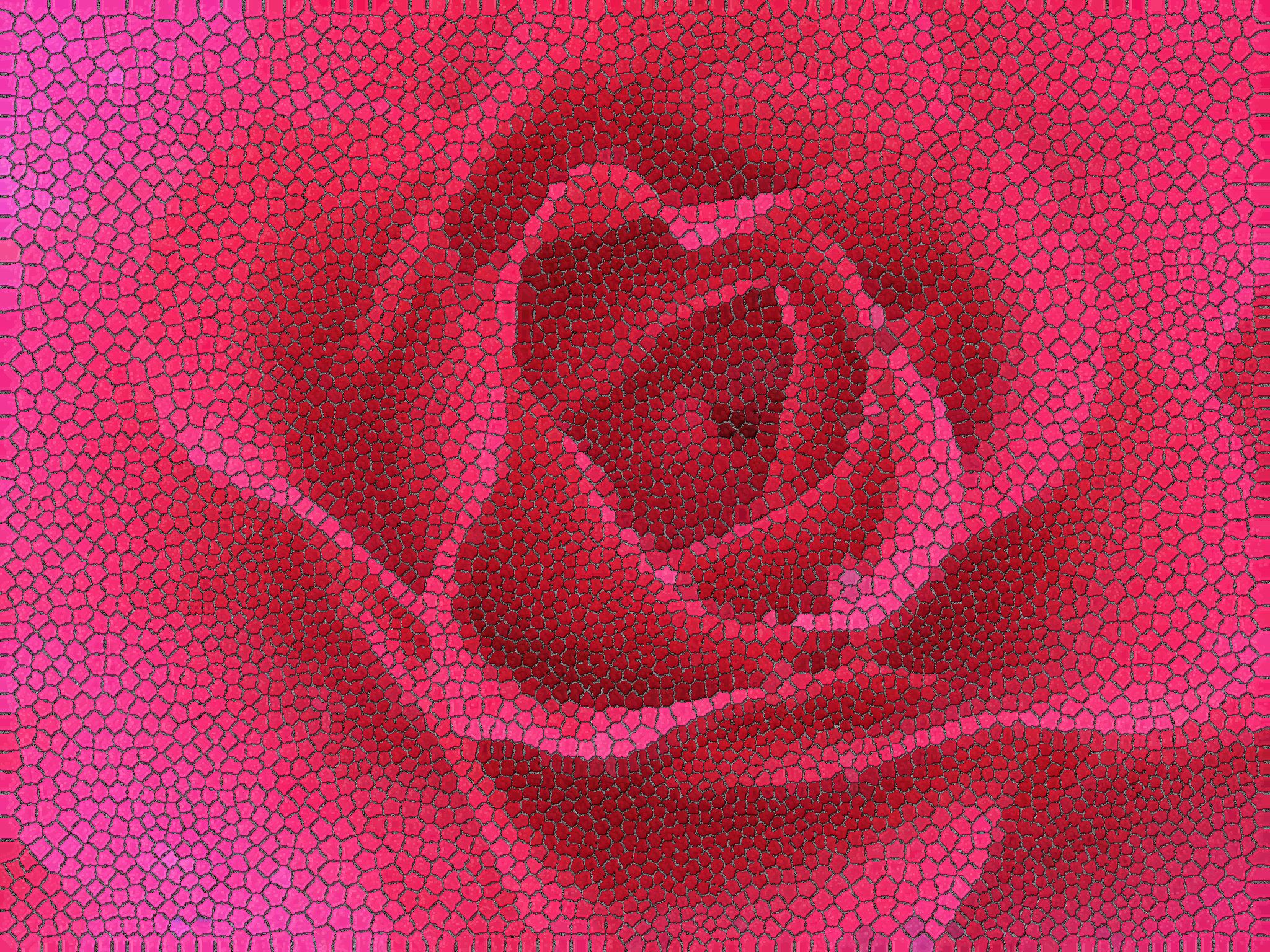

Started off using voronoi stipple and then fed the dots through G'MIC to create the panels. Still not as aesthetic to me as Dr. di Blasi's approach. :)
ref: http://www.fontplay.com/freephotos/seve ... 806-03.jpg

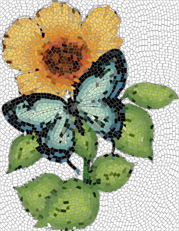

start mosaic.jar
select OPUS MUSIVUM + DIR.GUIDELINES
open your image (not too big...)
run CREATE
you get something like this
click on save
select the folder where to put in the outcome
save

Thanks dinasset that worked :bigthup

After running Voronoi Stipple (both image and negative of image into the program and blended the Dots in GIMP), I ran G'MIC's Skeleton preset (thinning; yes it's slow) followed by GIMP's Dilate filter to widen the outlines. I then inverted and ran G'MIC blend>shape Average (under customer Testing>lylejk>) with transparency. I then commenced to add dimension using G'MIC's Local Orientation preset (under Contours) to taste. :)

Glad you workedit out Graechan. The trick I use to further process the result is, after running the initial target image (gives you a colored result of course), I use the same parameters but change the image to a solid white one. This then gives you all white blocks. I then feed the result into GIMP, resize, then Autoequalize the image (makes the line darker). I then run G'MIC's Lylejk Stencil to clean the edges before using Blend (Shape Average) under Testing>Lylejk

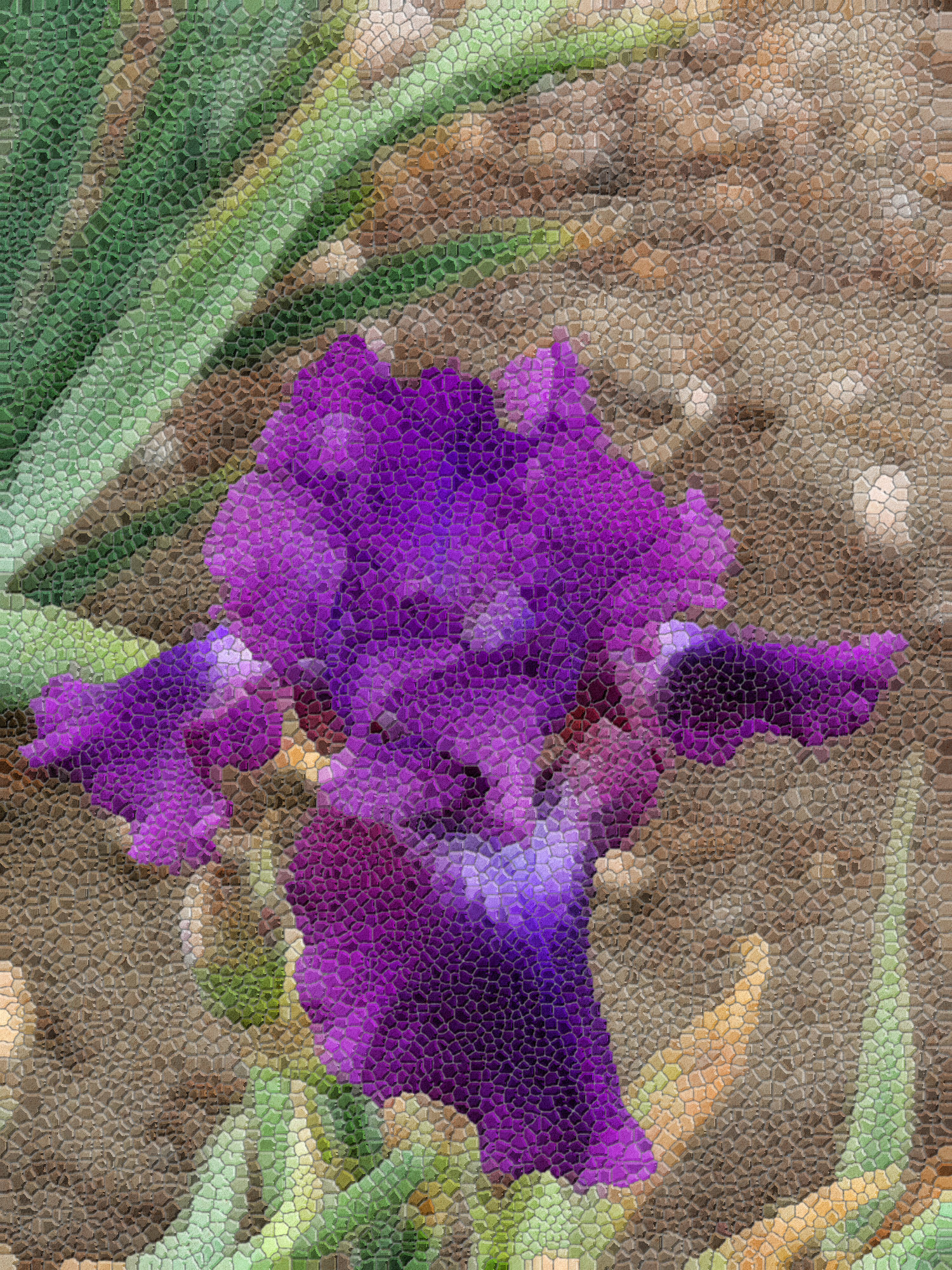

Here's another one; re-thought how to create the initial stippler mask in order to give more varying sized tiles. :)
ref: http://www.fontplay.com/freephotos/seve ... 406-03.jpg

This time I used Amphisoft's Xylograph filter (PS filter ran using Shellout) to create the Voronoi target mask. :)
ref: http://www.fontplay.com/freephotos/seve ... 506-09.jpg
