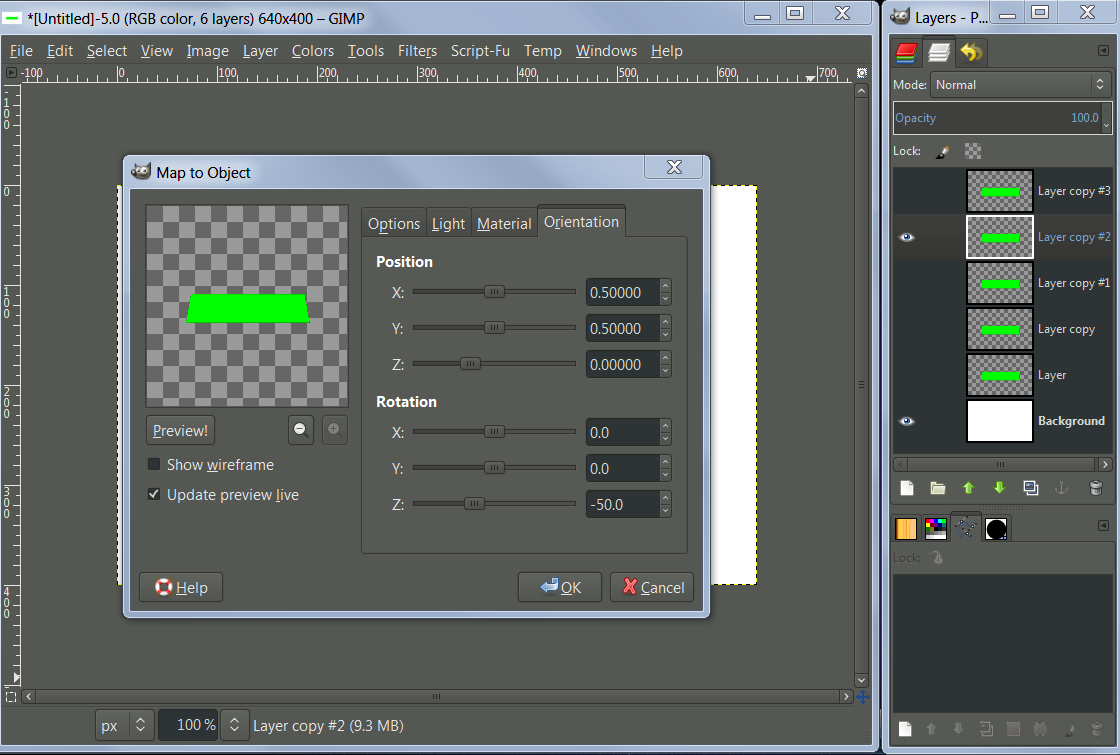

Begin on Layer copy #2 by setting the orientation for this layer using Map to Object>Plain.
I set the orientation to -50.0. It does not have to be exactly -50.0.
In my original image, I merely eye-balled the orientation for each of the layers.

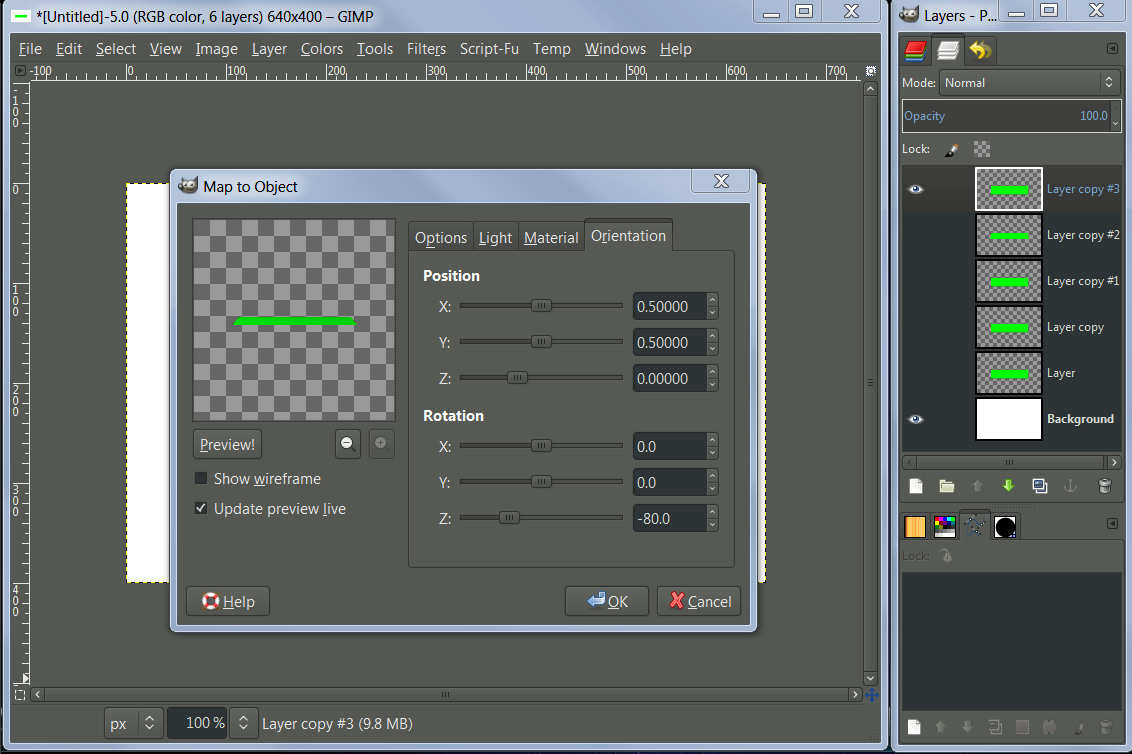

Next, set the orientation of Layer copy #3.
