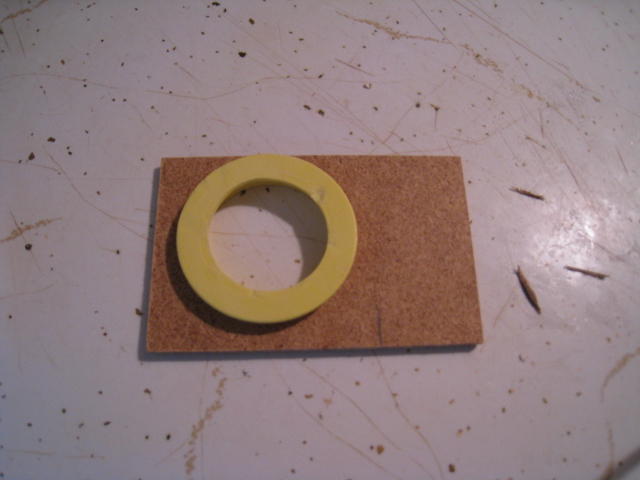

The mount backing with plastic ring drilled out to fit the camera lens (the mount doesn't work as expected):
It's going to require some new thinking. My idea is to create a small box the camera fits into perfectly, with the opening for the camera lens. Then glue a threaded plastic tube through the lens opening on the box, glue a female threaded cap onto the teleidoscope. Screw teleidoscope to box. That should make it permanent. Then I will mount it on a tripod this 4th of July and film the city fireworks display.
