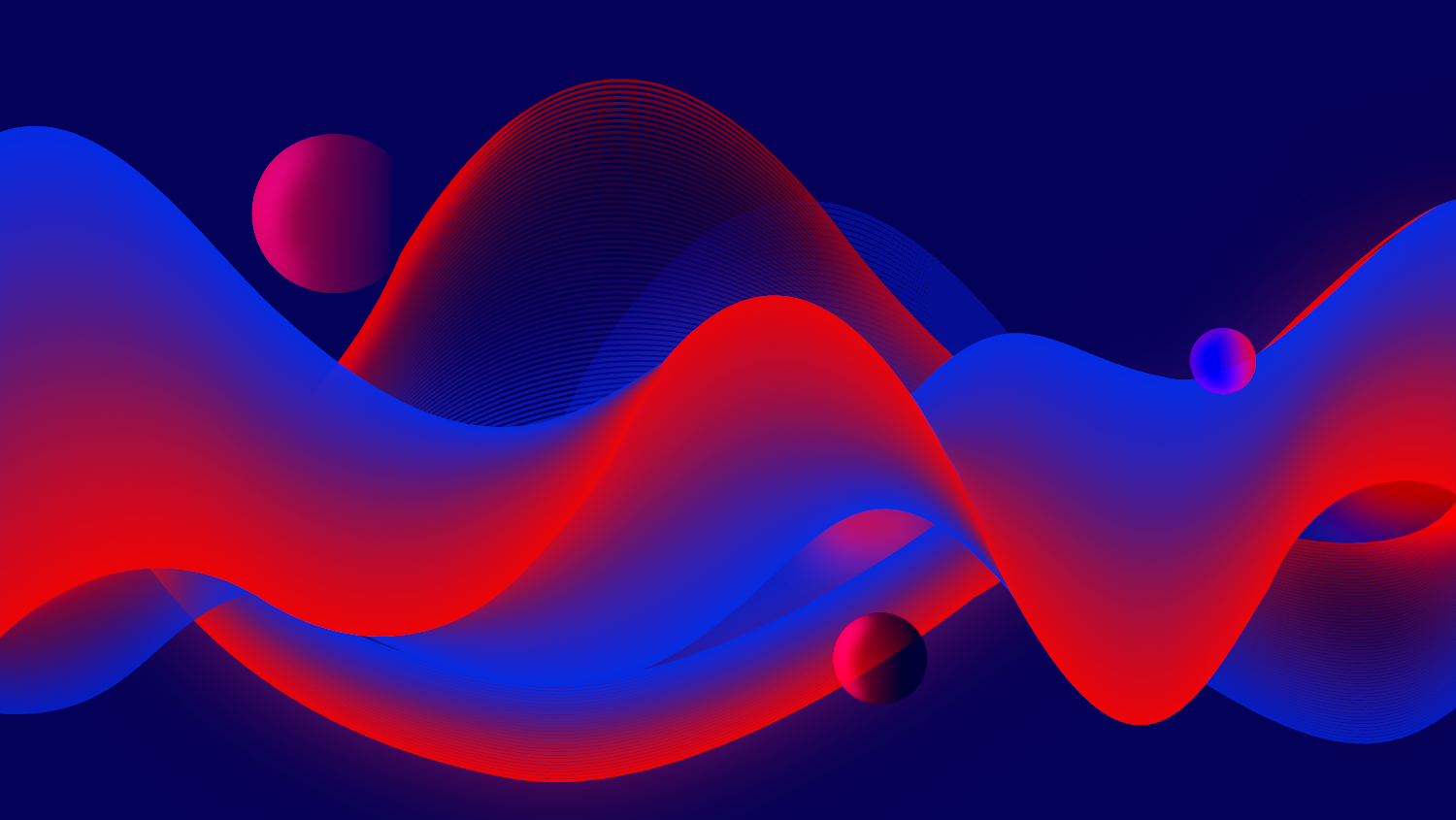

this is a result obtained with photoshop, can we also get that with gimp or with Gmic ?!
https://youtu.be/4YmkOomkD0I
link to the photoshop example

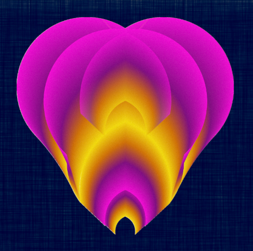

Yes, you can do it in Gimp. In this 'quickie' version I used three 'favourite' filters - Path Blend, Generate Intermediate Paths and Stroke Visible Paths.

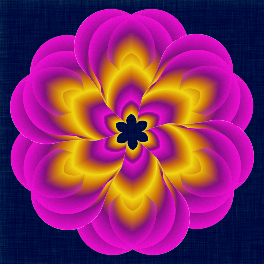

Just looking at options with Path Blend script in preparation for the tutorial/helper document requested above by Sallyanne; whenever I go back to using this script from Rob A, I am always amazed at its capability and flexibility. Here is something I knocked up using an SVG gradient, and then turned it into a brush, for a mandala of course.

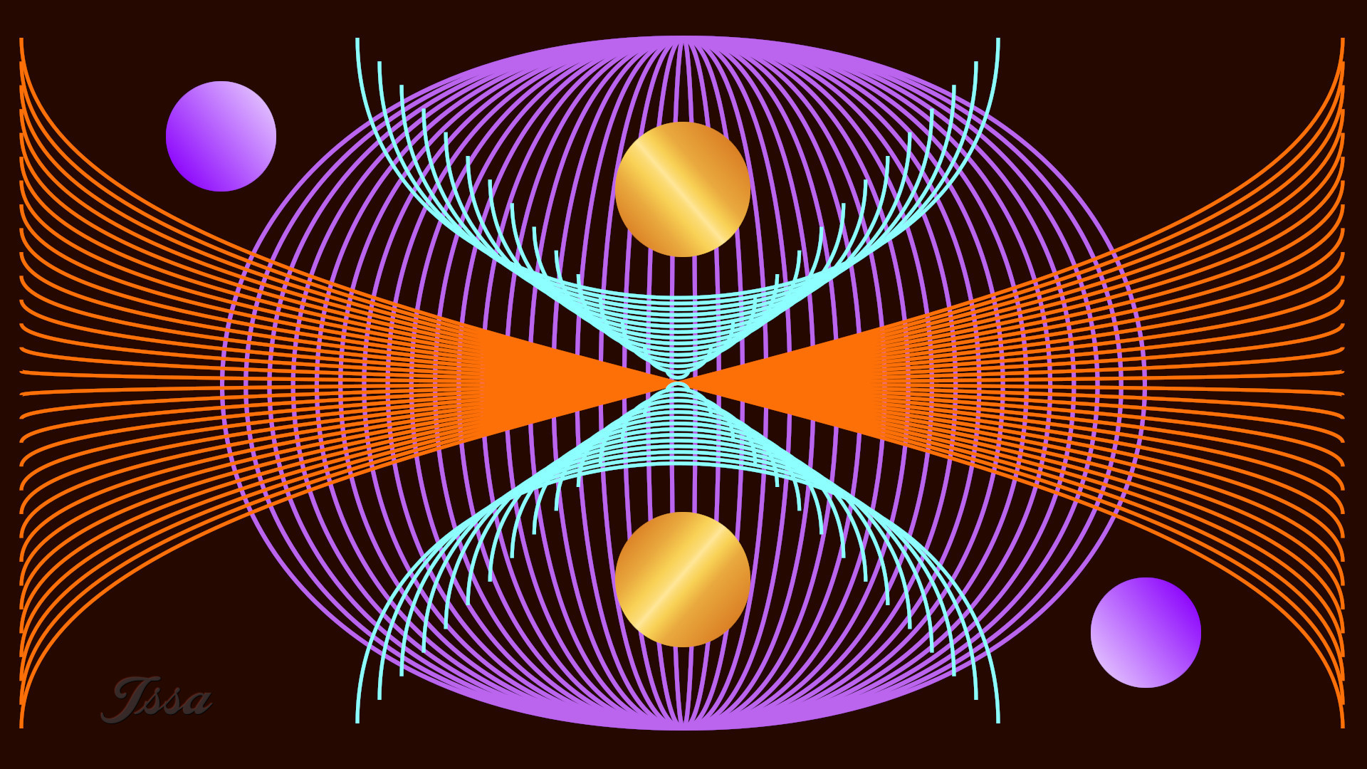

omg,
this is a great tutorial with a fantastic outcome.
not to mention thanks to the path blend scripts, congratulations also to those who wrote the scripts. (they are sometimes forgotten)
this is a first attempt, now we can experiment further.
gimper66

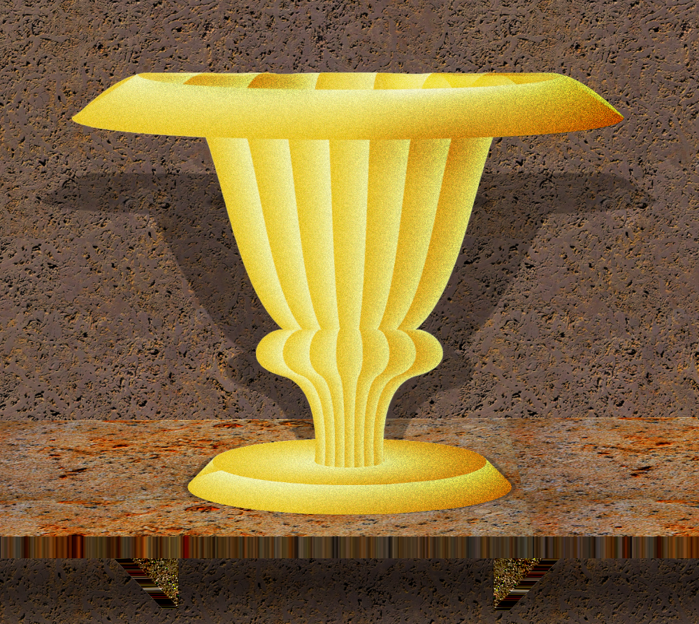

Gimper66 - thank you. You are right, it is all about experimentation; the gold urn below was created just using multiple Path Blends.
