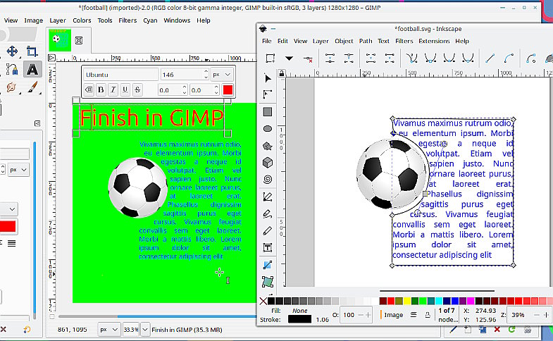

There is also Inkscape. Flow text into frame. Then into Gimp to add background...etc...

Rich2005's solution to the problem via Inkscape is what I do.

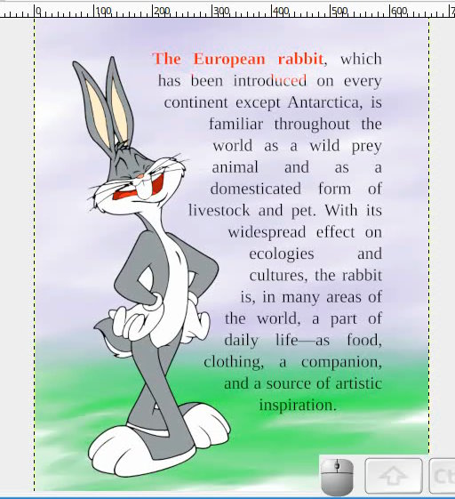

Sometimes a problem, Tin's plugins squashes / grows the text.
This is using Inkscape and the gimp-to-inkscape plugin https://www.gimpscripts.net/2023/07/gim ... scape.html Word spacing can be a problem here as well but it is possible to adjust in real time using Inkscape.
4 minutes duration https://youtu.be/p7Hd25vmKJ0
