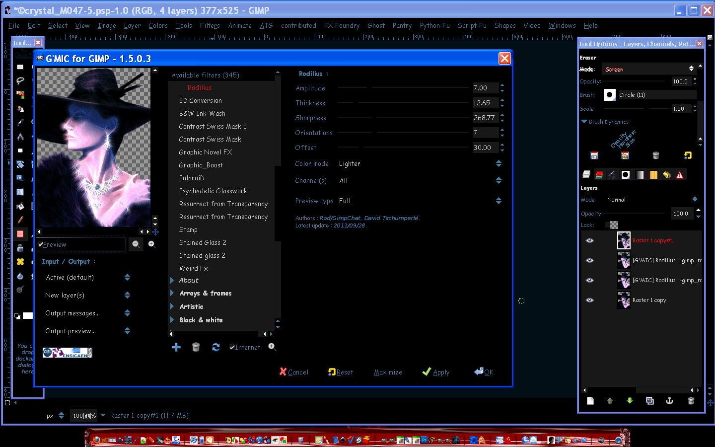

To get the effect -
Open your image
Duplicate it
Run Rodilius with these settings
Now duplicate that layer place it on top,and set the mode to divide.
Set the Rodilius layer under it to soft light.
The original should be at the bottom.
Now play with the soft-light mode layers opacity settings to get the effect.
Incidentally just having the first top Rodilius layer in divide mode produces some interesting cartoon type effects. ;)
