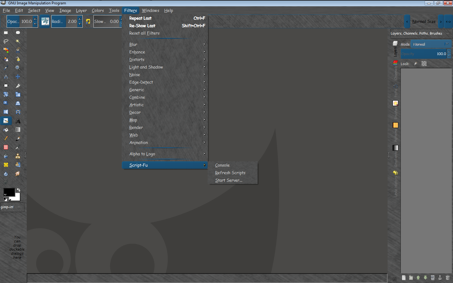

Wallace please keep in mind GimPainter is not a plugin but is a portable Gimp that looks like this
