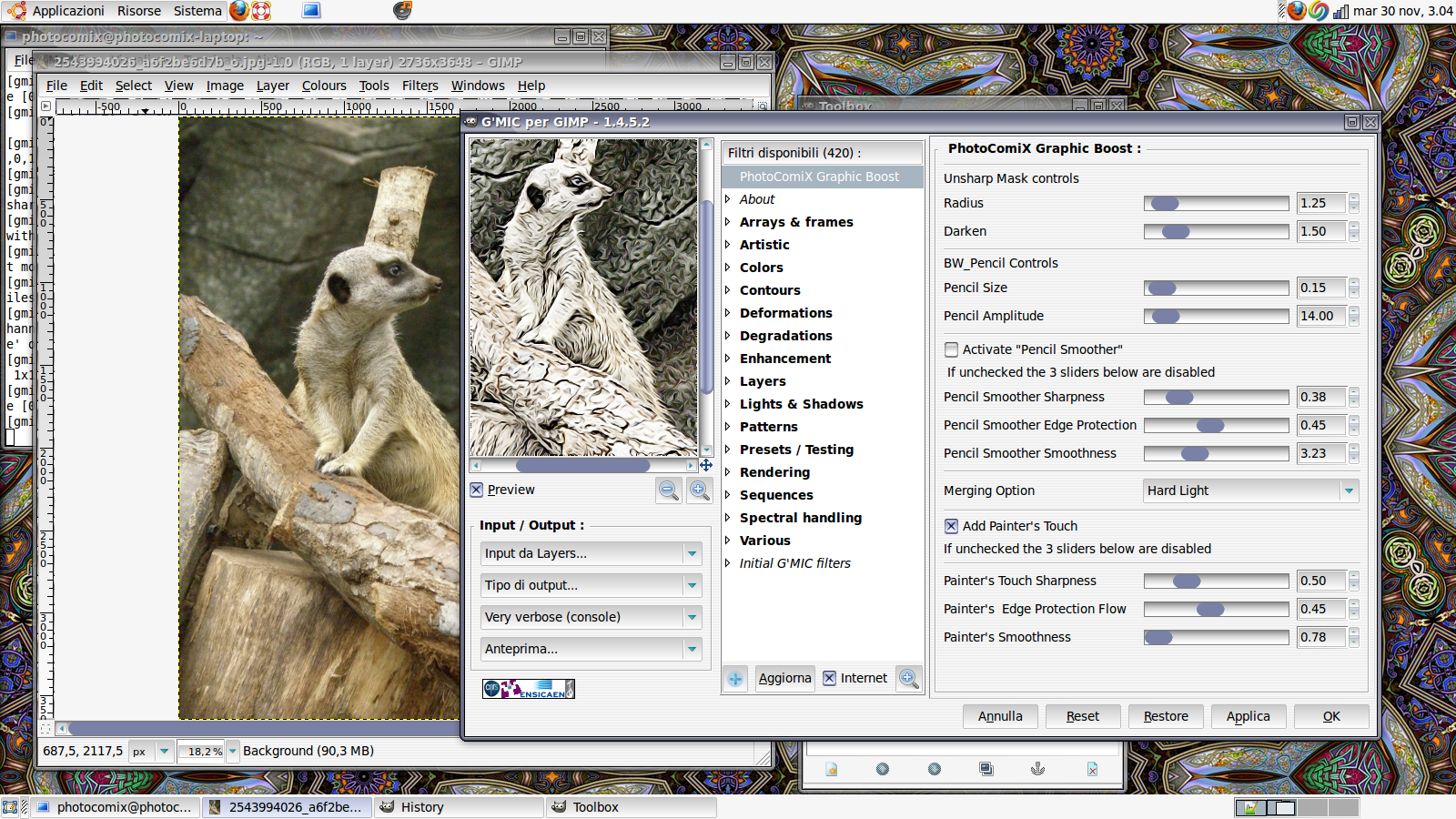

 Post subject: Re: Testing on Lions
PostPosted: Mon Nov 29, 2010 9:19 pm  (#11)
:jumpclap script is ready :jumpclap
and works (maybe it could works even betterin a future, but finally is ready and does work !)
for the most impatient copy the code below,
then if you already have a .gmic file in your home directory (close to a gmic_def.1452 and to a gmic_fav files) paste there
If not just save as .gmic there (in windows you may use Notepad plus to save as .gmic ...don't forget the dot...

photocomix_boost :
-gimp_unsharp 1,$1,30,3,0,$2,0.40,1,0,0,0
--gimp_pencilbw $3,$4,0,0,0
-if {$5==0} -gimp_do_nothing[1] -elif {$5==1} -gimp_anisotropic_smoothing[1] 60,$6,$7,$8,1.1,0.8,30,2,0,1,1,0,1,0 -endif
-if {$9==0} -compose_hardlight[1,0] -elif {$9==1} -compose_multiply[1,0] -elif {$9==2} -compose_softlight[1,0] -elif {$9==3}
-compose_colorburn[1,0] -elif {$9==4} -compose_darken[1,0] -elif {$9==5} -compose_stamp[1,0] -elif {$9==6} -compose_overlay[1,0]
-elif {$9==7} -compose_freeze[1,0] -endif
-if {$10==0} -gimp_do_nothing[1] -elif {$10==1} -gimp_anisotropic_smoothing 60,$11,$12,$13,1.1,0.8,30,2,0,1,1,0,1,0 -endif
PostPosted: Mon Nov 29, 2010 9:55 pm  (#13)
humm
i notice now that in the filter there is something wrong in the last 3 sliders, checking now
PostPosted: Mon Nov 29, 2010 10:02 pm  (#14)
FIXED
It was just a bloody,damned, cursed extra blanc space to make a mess
please if was so quickly to get before, replace with the corrected one
PostPosted: Mon Nov 29, 2010 11:21 pm  (#15)
Posts: 12851
OK PC; tried putting this where the gmic stores both the def file and the favs file and do a refresh, but I Don't see you plugin. Even tried putting it the plugins directory for GIMP but don't see it. Not sure if this is an issue with Win7 or not. Oh well. Don't feel like burdening Dave with this one right now. Might try to hack at it later. :)
PostPosted: Mon Nov 29, 2010 11:56 pm  (#16)
i answered already
but anyway i hope you have something better then the notepad ,notepad++ would be perfect
Simply copy the script ,paste and save there (i see you already find where ) as .gmic
just .gmic but not forget the cursed bloody dot, without the dot before the name no joy (that's why i suggested Notepad ++ instead then M$ notepad, M$ notepad may choke complain and start to make fuzz at any attempt to save with a name starting with a dot)

Posts: 12851
Your solution that you posted at Flickr worked. For the other novice folk like me, follow the thread at the end of my comments. Like your preset by the way PC. Think it's a keeper.
http://www.flickr.com/groups/gmic/discu ... 372068491/
PostPosted: Tue Nov 30, 2010 12:50 am  (#20)
Hooray! Profound thanks for the preset, PC!
