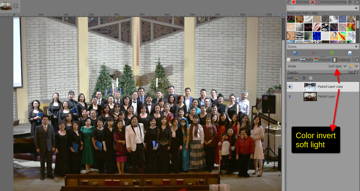

I'll give one more option
Duplicate
Colors > Color invert on the duplicated, and just put it in soft light mode
(this will lighten what need to be lightened and darken what need to be darkened as an "average")
Then right click on the layer stack > "New from visible" make your final adjust/sharpen/and-so on that one :bigthup
