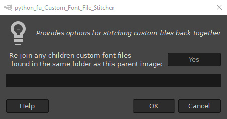

When you have installed the plug-in fire up Gimp.
Open the parent custom font file 'Happy-Donuts_Caps_Striples.xcf' from the File menu:
File>>Open...
and navigate to the file location.
After the file has loaded and you can see the custom font layers in the layer stack, call up the plug-in from its location:
Filters>Custom Fonts>Constructing Tools>Custom Font File Stitcher...
Click on 'OK' and that should be it. If it works then great - otherwise boo-hoo.
