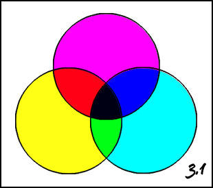

all those in between. In the subtractive world, color is determined by the absorption
of light. When the secondary colors (cyan, magenta, and yellow) are combined, they
will create black-brown, as shown in 3.1.

Like a common ink jet printer, shows us a good illustration of this subtractive
at work. In creating inks for printing, impurities in the pigments result in muddy black-brown
when you combine cyan, magenta, and yellow together. To achieve rich shadows and pure
blacks, black was added to the printing process to be able to create those colors. By combing
