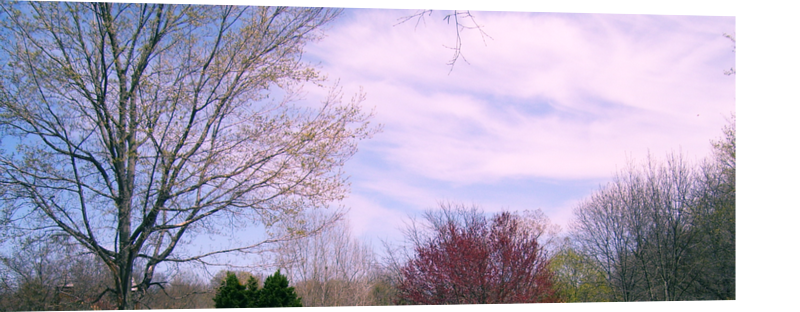

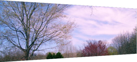

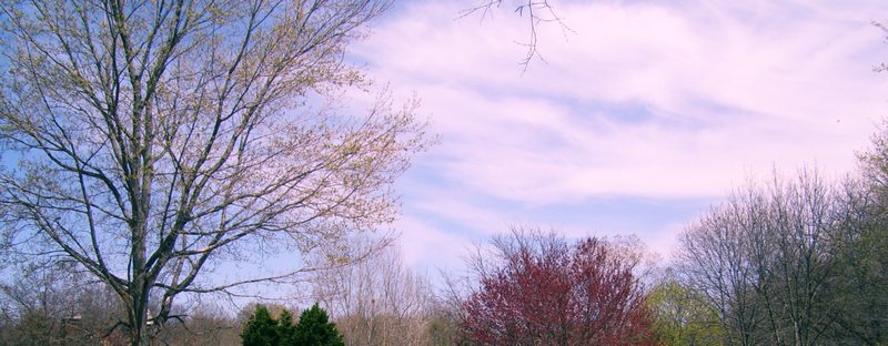

I created this bat file for Windows users.
Program only tested on the Windows XP 32 bit platform.You need to have image magick installed.
Any PNG Perspective Transformer.
You can unzip the bat and image file here - C:\Make_Perspective. (create the Make_Perspective folder)
Any PNG image you want to transform rename it to 1.png and drag and drop it on the bat file
the image will be transformed and saved as 1_pers.png in YOUR user directory.
Now just rename the file and your good to go.
Transform this
INTO
AnyPNGPerspectiveWin32-v-1.0.zip [599.47 KiB]
Downloaded 157 times

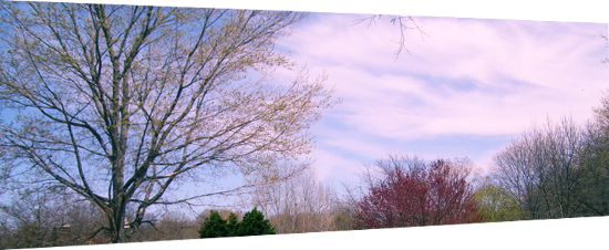

If i could find an open source program for windows that would do this type of perspective transformation that would be pretty cool.Then i could just call the program through shellout as normal.
Have you tried GMIC, Artistic, Reflection?
Just set the Height to "0".
File comment: GMIC, Artistic, Reflection
Is there any way to get the edges less jaggy without cropping?

I just used the Perspective tool on this one.
File comment: Perspective Tool only
