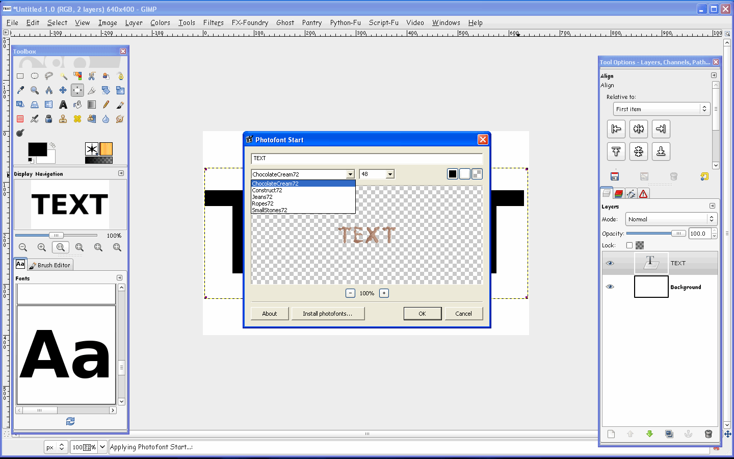

I corrected the link so it takes you directly to the dl page for the Adobe plugin.
http://www.fontlab.com/photofont/photofont-start/
I will try and see if i can get it to work through Gimp>Shellout>Xnview, or just through Gimp. :)
Thanks Rob!
Cool find.
In windows the default install is into common files/adobe/plugins/filters
copy everything in there to another directory and point PSPI to it , and it works quite nicely through Gimp.
Just create a new doc - create a new layer (transparent one).. Select that layer and run the plugin.
Select a type of photofont you like there are several (shown in the image below).
Select a size click ok and there you go. :)
I suppose you could also just copy the 8bf file into Xnviews plug-ins folder and it will work through Shellout also.

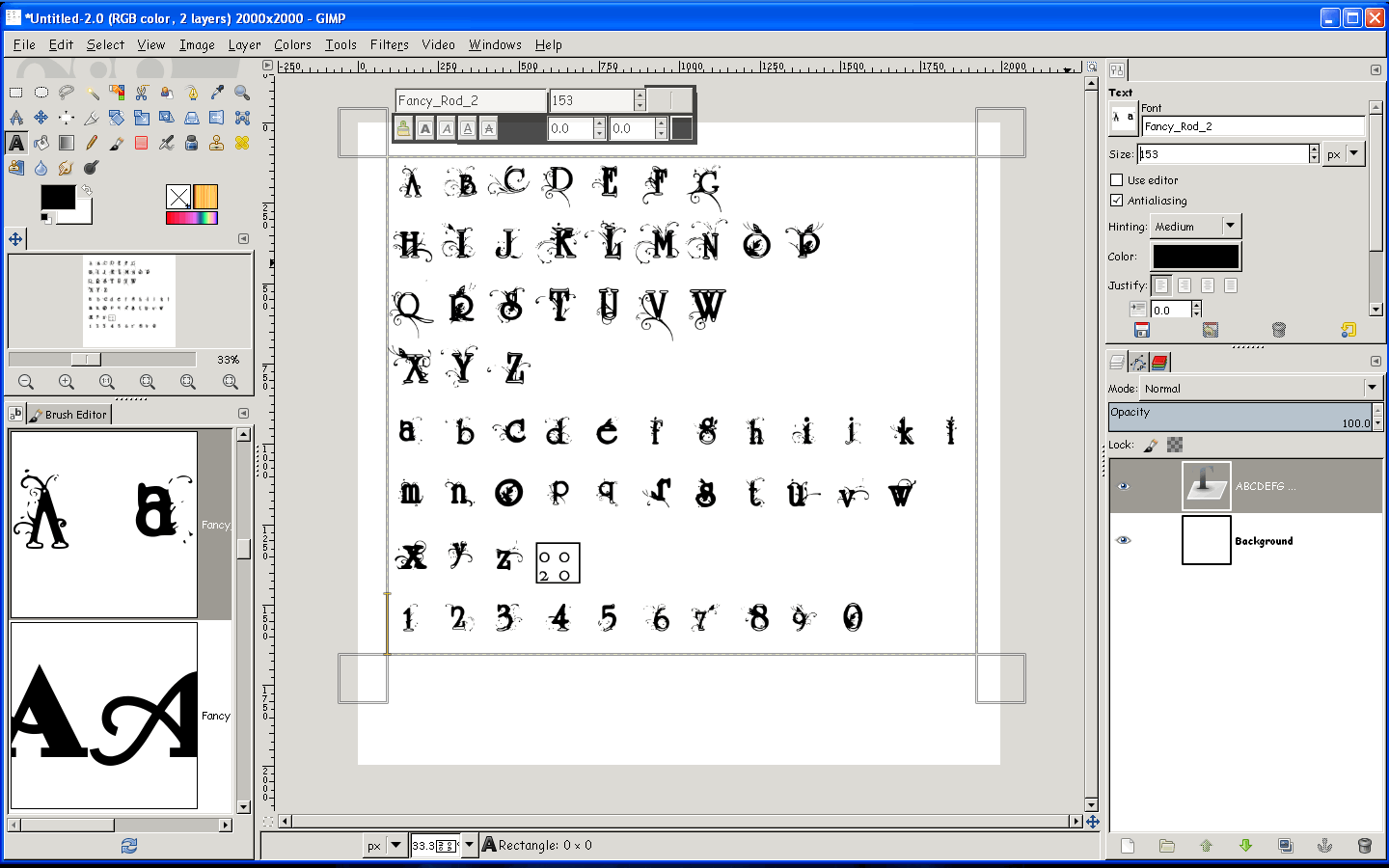

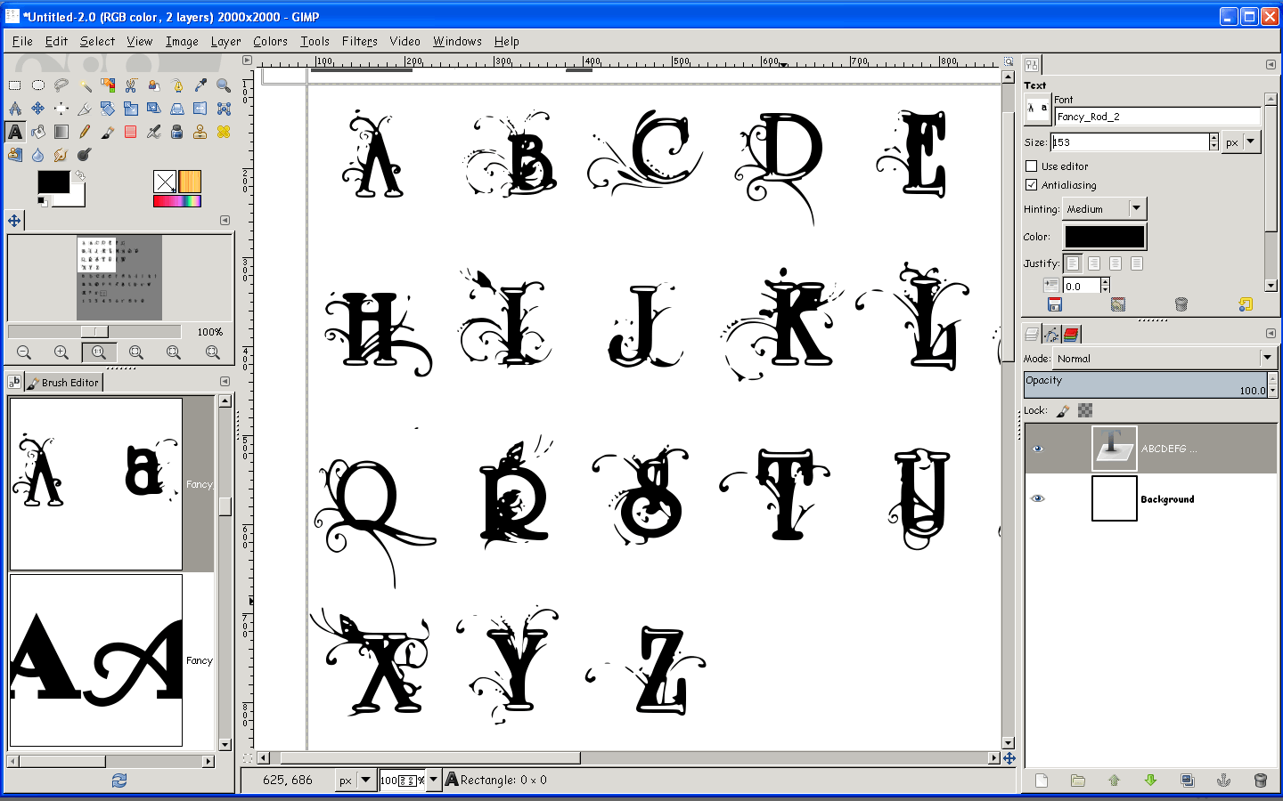

I think i got the font converted the best i can.I created each letter and number as a single png file and imported them one at a time into Inkscape.I then converted them to a svg file and converted that into a usable font. :)
Fancy_Rod-2 attached.
Fancy_Rod-2.zip [33.54 KiB]
Downloaded 258 times
If you installed the previous Fancy_Rod font, You will have to remove font-3933 and install this one.You will find it in your list as Fancy_Rod-2
Image example - the lower case z is kind of funny still.
A closer look -
