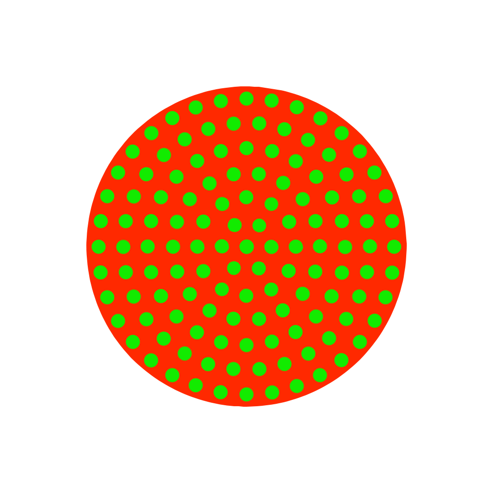

Could someone take on this request and create a script for stroking concentric circles for a pattern like we were discussing here: viewtopic.php?f=11&p=56545.
bkh1914 came up with the perfect solution towards the bottom of the page, but not everybody (including me) is a math geneious. It would be wonderful if this was made into a script, or python script, or even better, perhaps this could be made a part of G'MIC under Patterns or Arrays. I would think that having a preview window like G'MIC uses would be a must for this. Using different shapes would be cool as well as the current brush parameters.

Thanks for the input Rob but I think you guys are missing the point altogether. Making the concentric circles is not the issue, the math and the stroke are the issue. I'm looking for a script that
1. Makes the concentric circles (maybe calls another script into play to do it)
2. Does the math to set up the placement of the stroke (spacing to make patterns and arrays)
3. Makes the stroke based on input parameters and brush selection.
or
At least perform 2 & 3 after you have used one of the other methods for creating the concentric circles. Just want a way to automate the whole process without having to
take a course in trigonometry or something to figure it out each time. LOL
Making patterns is simple really, until you get to the radial application. If you make a line of dots/circles whatever, then use Copy-Rotate you get this after erasing a few overlaps near the center.
but to get a concentric radial hex pattern requires the math that bkh provided. I dunno what the numerical representation is, or how amny decimal places that I need to use for pi anyway, but if the process is "simple" like bkh says, (no sarcasm intended) why can't someone automate this entire process to produce this...

When you stroke a path, the dialog gives you an option of a line or a brush. If you select brush, it picks up whatever brush you have your Brush tool set to at the moment so the scrip calls for that particular brush in that manner. No problem. (and it doesn't have to mop the floor) If a script can be set up to make concentric circles (Script A) and another one to Stroke the path (Script B) why can't we create another one to set up the math required to make the pattern AND use a combination of script A & B? Each stroke for each concentric path requires that simple formula that could be built into the new script.
To make a short story even longer......a script to make the pattern of dots like the bottom image in my post above. If possible, maybe even different patterns based on different math. Call the new script Pattern Stroke.scm or .py or whatever.

I ended up using a vertical line and then the Copy-Rotate script to set up several layers with lines/guides at different degree settings and then manually placing the dots at the intersections of the radial line/guides and the concentric circles. Pain in the A.. but it works for now anyway. Anything you can come up with will be greatly appreciated. Who knows, it may lead to something even better.
The illustration you used above looks as if the rectangles need to rotate as they are stroked so the spacing looks better, but that's in the brush setup correct?
The issue I was trying to illustrate is that there are problems with a rectangular brush - any brush that whose width and height are different.
I'm still on GIMP 2.6.12, and rotating requires an animated brush (.gih). That would fix the spacing issues since the width and height of the animated brush would be the same.
I also had an issue with the brush size and had to scale it to get the spacing right - the maximum spacing is 200%, which is too small for small brushes. (I'm not sure about the spacing through Script-Fu since the documentation on the call isn't doesn't say what the units of measure are and I haven't tested it yet.)
I could stamp the brush and then copy and rotate the layer - which is what you did manually. That solves the spacing and rotation issues. It's a little more time consuming. A minor disadvantage is that it will lead to some fuzziness. Another drawback of that is if you are using an animated brush, you'd only get the first layer.
Like I said, it is a more complex problem. :(
