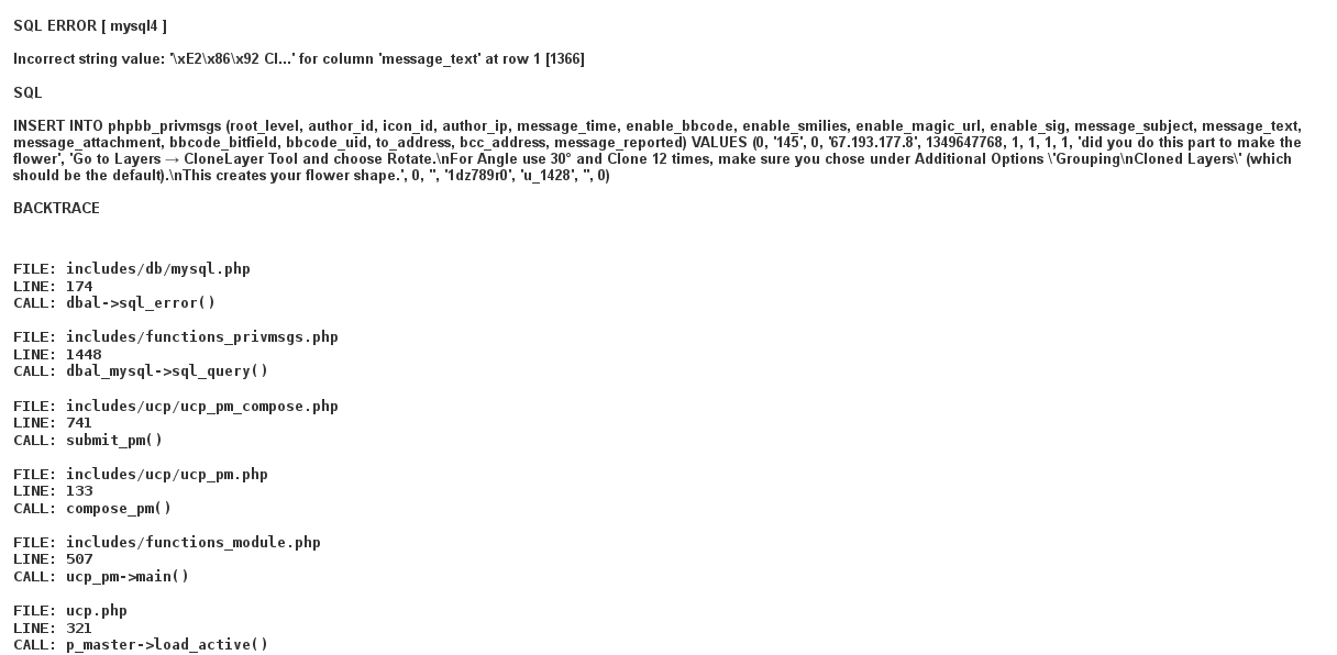

I get an SQL error when I try to send a pm.

I can send PMs OK. Is this a "one of a kind" error or do you get this message with any PM you send?
I'll check the server error logs for any other details I can find.

What happens is someone asked me how to do a certain step in a tutorial and I copied and pasted that one part of the tutorial into the pm. That is the part that wouldn't send. It is weird. This is what I posted below
Go to Layers → CloneLayer Tool and choose Rotate.
For Angle use 30° and Clone 12 times, make sure you chose under Additional Options 'Grouping
Cloned Layers' (which should be the default).
This creates your flower shape.
And that text has a non-ASCII character in it:
Try replacing it.

okay, that makes sense, thanks Kevin. :oops:
EDIT: that did the trick Kevin, thank you.
