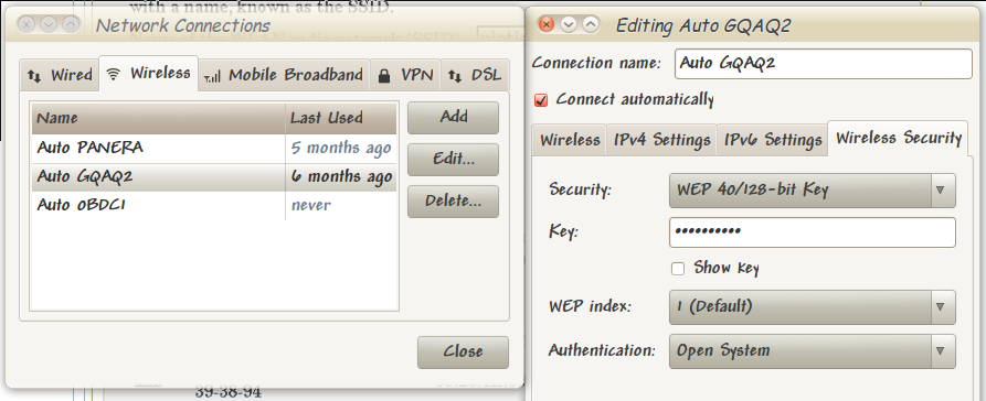

this is what my Network Connection program looks like (the wireless part, anyway)
can't say it will help you but at least you know what it looks like
