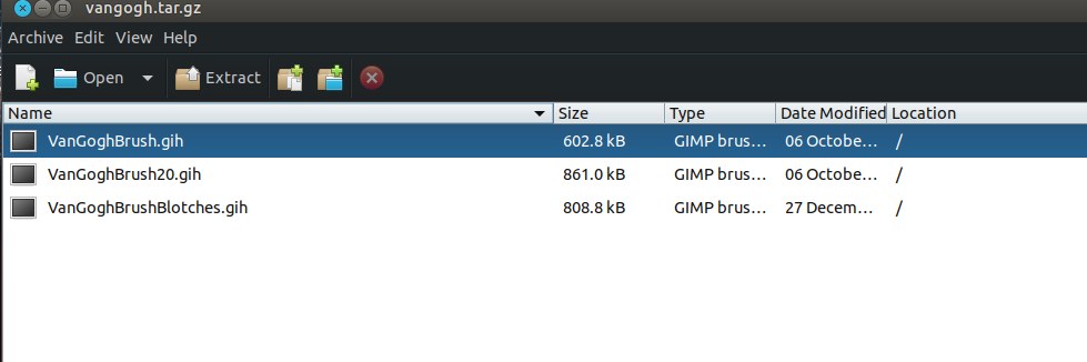

Do you also happen to have my van-gosh brush saved too?
 Post subject: Re: Plug-ins from the old gimplearn.net
PostPosted: Thu Oct 10, 2024 6:07 am  (#7)
Joined: May 24, 2021
Posts: 859
are those your vangogh brushes (3 inside)?
vangogh.tar.gz [138.16 KiB]
Downloaded 68 times
PostPosted: Thu Oct 10, 2024 6:16 am  (#8)
Posts: 4561
I think so they do look familiar naming.
thanks
