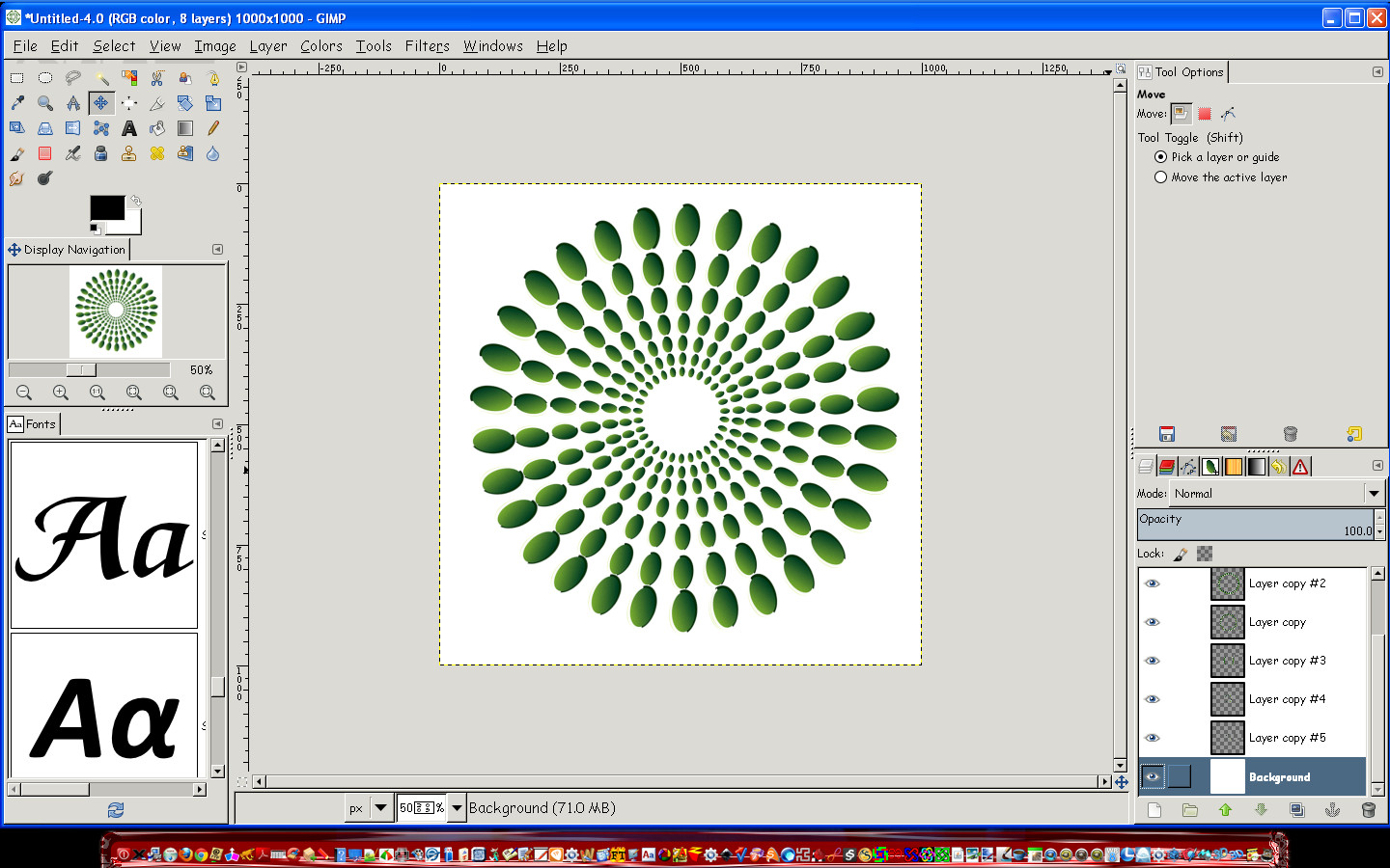

The brush is the ellipse
Using brush to stroke a circular set of paths (set within each other on separate layers), then scale each layer would perform the same results. :)

Example

Not quite what you wanted. Anyway, created a single over brush and then tiled Horizontally and used theilr's Pan to Bow to create a Circular ring. I then dup/shrunk/rotated the ring. I then ran Mathmap's Droste9 (as a side note, the original Droste9 didn't work for me, but when I downloaded Graechan's files when he shared how to get Mathmap to work with 2.8, his worked and so did many other of the presets that didn't work for me in my version of Mathmap; not sure if Graechan indeed fixed the presets or my install was corrupted when I did them at that time) to create the result. Also, just another excuse to create a wormhole. lol :)

That is a keen idea Lyle.Using a straight line of brush strokes and then bending them in a semi circle. :)
Love the way you laid that image out too. Very eye boggling. :lol

Hey Lyle you created another pretty nice circle of shapes with brush dynamics too.That would be another cool way to do this. :)

Posts: 12856
