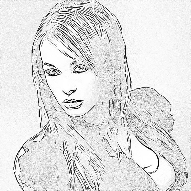

PostPosted: Tue Dec 28, 2021 6:03 pm  (#10)
Posts: 14268

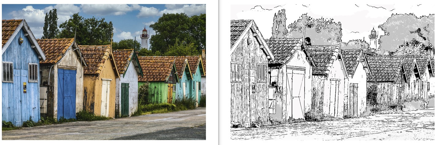

Using the approach described below.
I managed to get this result.
Your mileage may vary.
Image To Line Art
Duplicate image 2 times.
Top layer: Reduce saturation to -100.
Set layer mode to saturation.
Middle layer: Set layer mode to dodge.
Invert color, Gaussian Blur image.
Note: Image size determines the amount of blur.
Bottom Layer: Adjust color levels as desired.
 Post subject: Re: Convert Color Photo to Line Art (Plug-in or instructions)

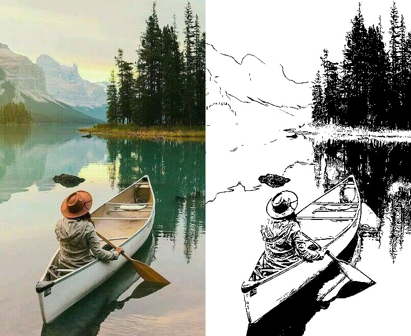

I post my way if someone is interested in it. :paint
Photo_To_Art_Line by Issa.pdf [1.41 MiB]
Downloaded 256 times

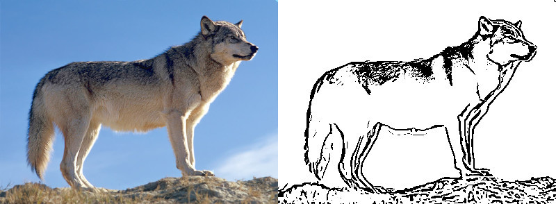

PostPosted: Thu Dec 30, 2021 4:52 pm  (#17)
Joined: Apr 19, 2021
Posts: 138
Hello! :)

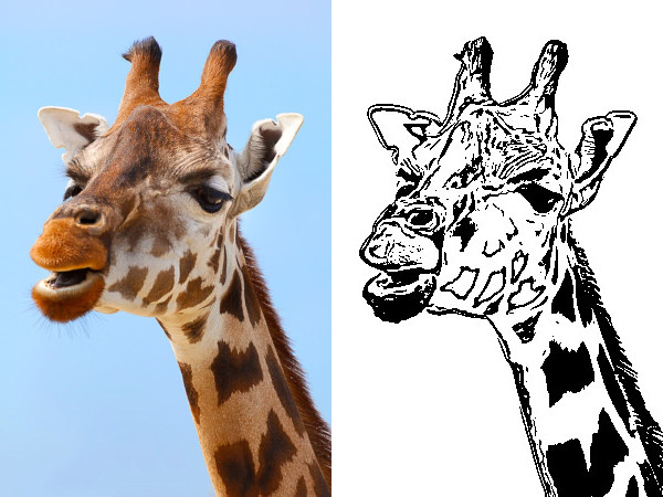

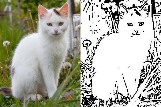

Here is yet another way:
  • Filters -> G'Mic -> Artistic -> Comic Book
  • Filters -> G'Mic -> Various -> Custom Code [Global]
    and paste
    fx_blackandwhite. 0.299,0,0.587,0,0.114,0,0,0,0,0,0,0,0,0,2,0,0,0,16,4,0,0,0,50,50
    otsu. 4 n. 0,255
Here are examples:
Hope this helps!

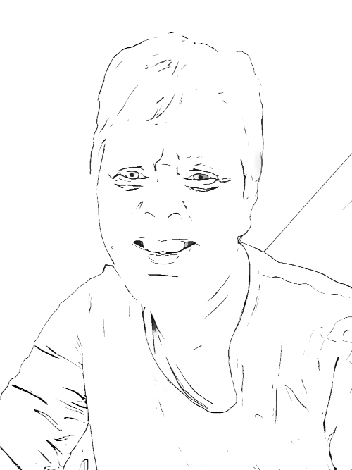

PostPosted: Fri Dec 31, 2021 11:02 am  (#18)
Posts: 14237
Thank you so much cli345; it works great! :coolthup

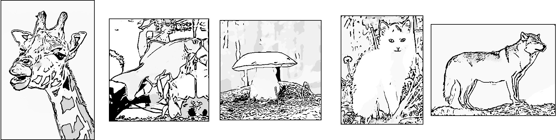

Here are examples:
Hope this helps!

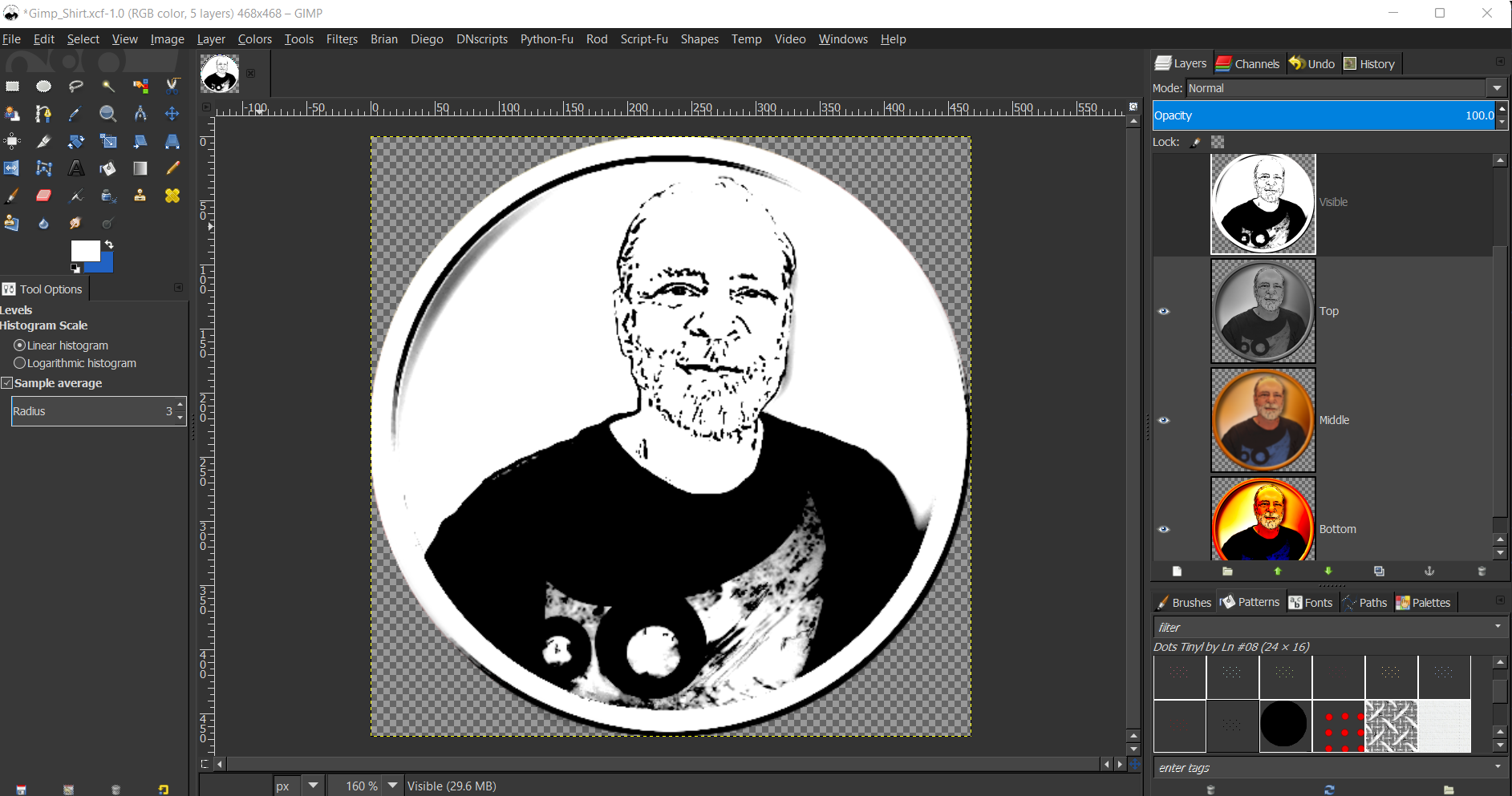

PostPosted: Sun Jan 09, 2022 3:34 am  (#20)
Posts: 14237
cli345, thanks again. Yes, the second code helps a lot. I see the lines being thinner with a nice result. :coolthup :tyspin
