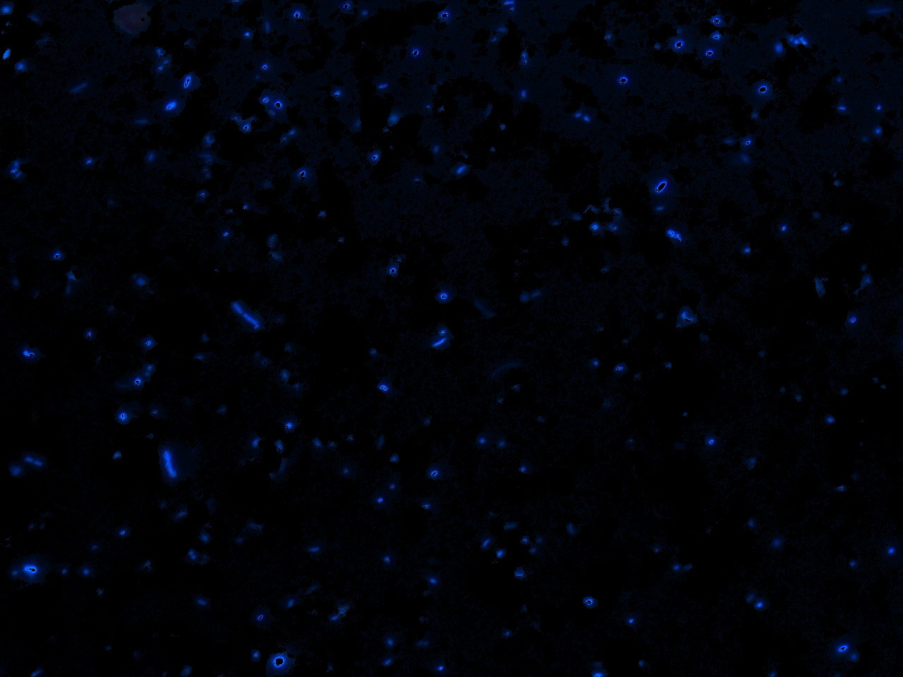

I am fairly new to GIMP and know what to do to get my images the way I want them, my problem is writing a macro to aid me in doing this to hundreds of additional images. Im used to simple macro scripting where you just record, this is on a whole new level. If someone really knows how, please can you help with the scripting of the following. The image will be open in GIMP prior to the following:
1) Decompose the image to LAB, the decompose to layers must be checked)
2) Switch off the L channel in the new image
3) Select the A channel
4) Set paint color to 50% grey
5) Fill the whole A channel with 50% grey using the bucket tool
6) Switch off A channel and select B channel
7) Stretch Contrast of the B channel
8) Switch on the A and B channels
9) Compose to LAB
10) Decompose new image to RGB
11) Delete the R and G channels
Well, thats it.. Any help would be greatly appreciated.
I have attached a tiff file as an example of what I am currently working on.
Thank you
File comment: Epi-fluorescent staining of bacterial cells (blue) and the auto-fluorescent sediment (yellow).
1.tif

1.tif

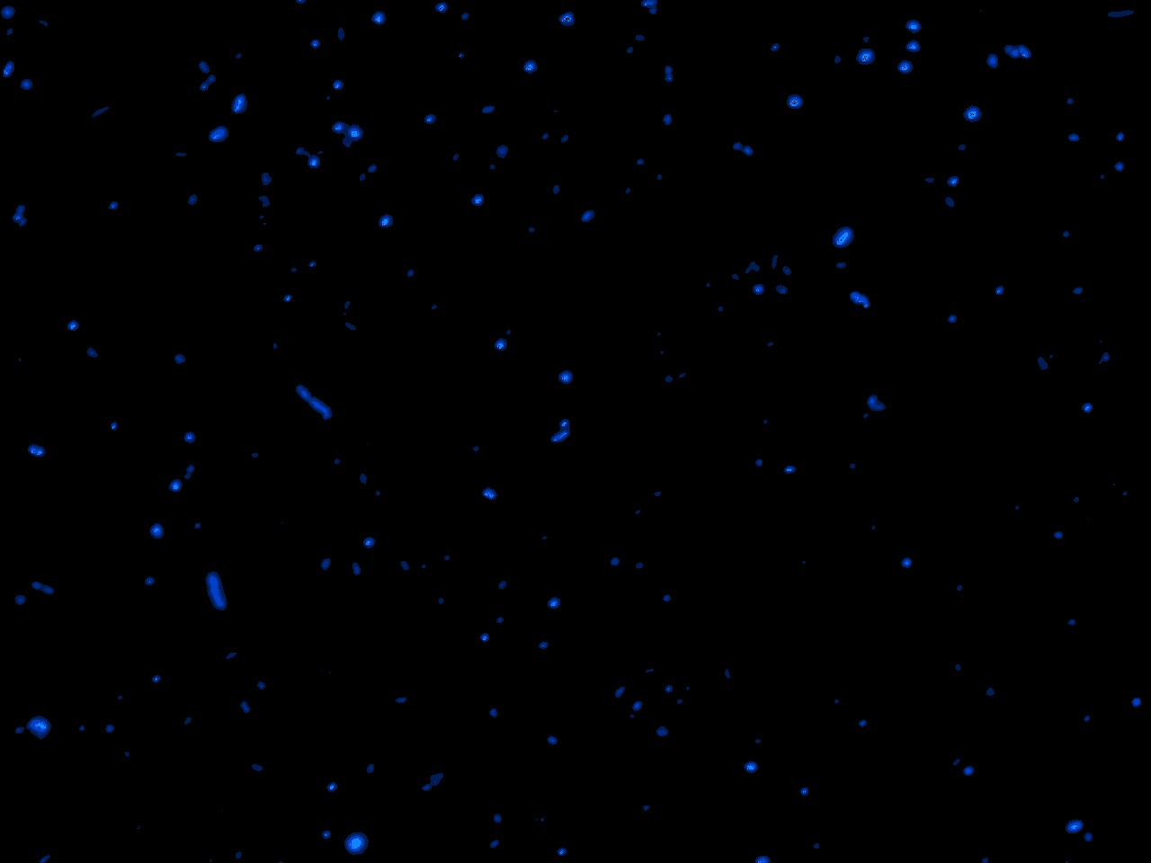

Posts: 8511
Followed your instructions and came up with this. Maybe someone else can help with scripting.

Yes, that is what I need, and I can do that... I need a macro script to do that a few hundred times over.
Doing it manually will just take forever!...

Hmm. Using LAB seems overly complex. LAB is a perceptual thing. Looks like what you what is keep only what has a given Hue and Level. Your processing:
