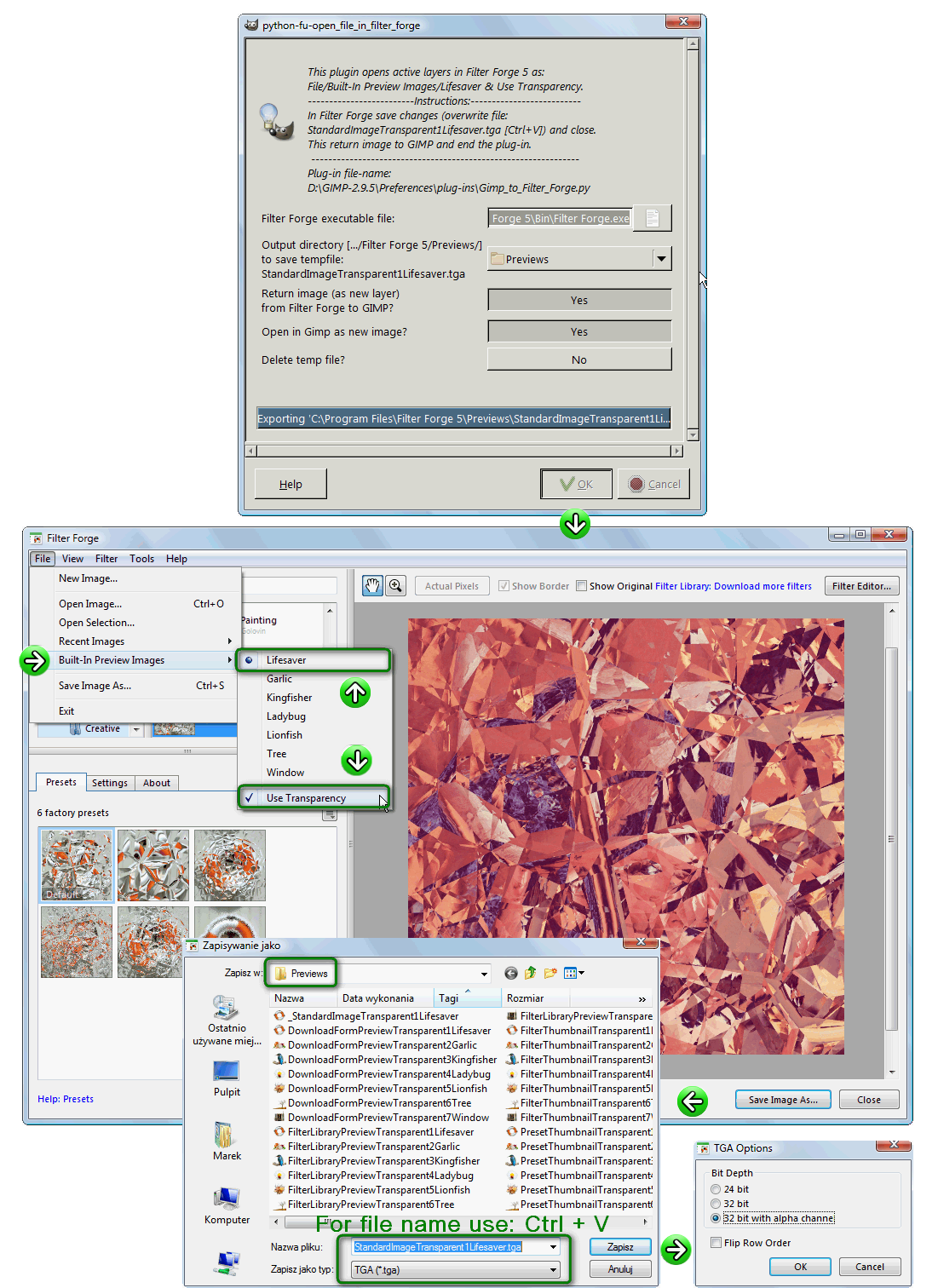

PostPosted: Thu Mar 30, 2017 6:14 am  (#19)
Rod wrote: Unfortunately no there is no way to run FF through GIMP at this time....
Imperfect method - for test use: Gimp_to_Filter_Forge.py [in menu: Filters/Filter Forge/Filter Forge 5...]
This plugin replaces the original file (Save / copy the original file .../Filter Forge 5/Previews/StandardImageTransparent1Lifesaver.tga - if you want to use it) serving as a preview in FF with the option:
File/Built-In Preview Images/Lifesaver & Use Transparency
The file name (very long) is copied to the clipboard - so when you save in FF you can use the keyboard shortcut: Ctrl+V
Gimp_to_Filter_Forge.zip [2.48 KiB]
Downloaded 175 times
 Post subject: Re: Filter Forge at GAOTD is free today only.
PostPosted: Thu Mar 30, 2017 7:28 am  (#20)
Posts: 16298
Tested in GIMP-2.8.20 64 bit with Windows 10 64 bit. =)
It did load the Filter Forge 6 Pro 64 bit interface.
BUT... i couldn't save the changes. Or maybe i am doing it wrong?
Does the file have to be saved as "StandardImageTransparent1Lifesaver.tga" ?
