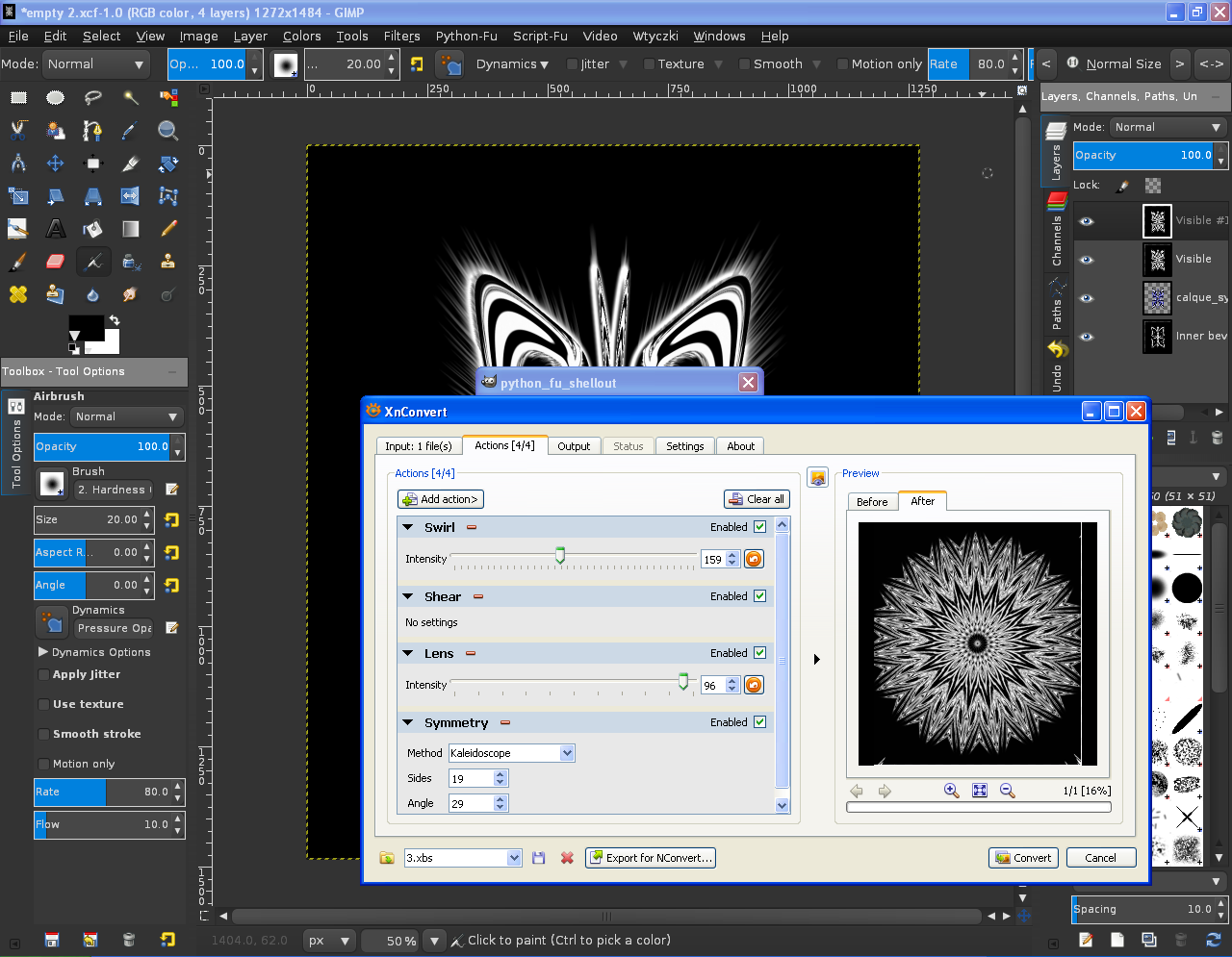

http://www.xnview.com/en/xnconvert/
How for me - revelation !

I suppose you use this with Shellout?

@MareroQ: is exact what said by Rod?
@Rod: I tried with the shellout function, but - after having done some action with xnconvert - result is NOT returned to Gimp (it DOES return result with xnview). Can you try also?

Yes - I use ShellOut.py
["XnConvert", "\"C:\\Program Files\\XnConvert\\xnconvert.exe\"", "png"],
It is important to set "Output"

OK, the difference with what I did is to KEEP the original filename, thanks; so, it worked!
