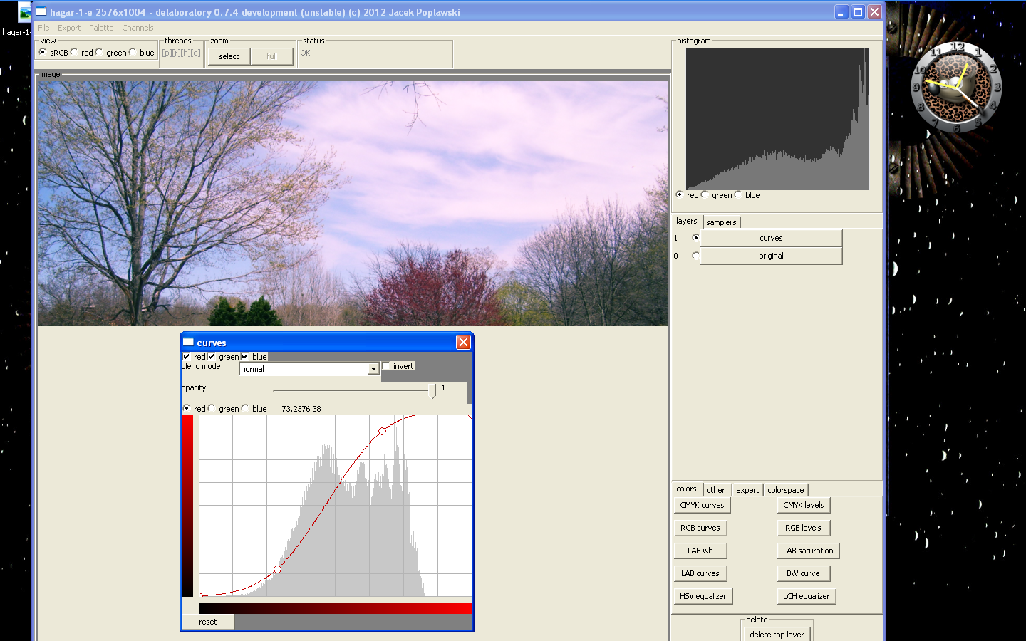

Downloaded Delaboratory-0.7.4-32bit. Everything works fine except if I try, "Send to Gimp". The following screen shot shows the Delaboratory error message and below it the actual path to the temp file. Note the forward slash in the Delaboratory error dialog.
File comment: Delaboratory error

Do you have gimp-2.8 installed?
You can always export TIFF and open it in Gimp manually.

I think we already mentioned before that you need my Gimp builds to get "Send to Gimp" to work. You need Gimp 2.8 or higher.
I don't know how Ender packages the official Gimp to figure out how Gimp is started when you start from the commandline.
Can you start Gimp from the commandline using verbose (gimp --verbose) and provide the output to me?

Currently gimp is started by calling "gimp-2.8" executable, we can replace it with anything else, on Linux it is just "gimp". But we can't make it definable by user because there is no user configuration. So propose any solution if you know it. We can also create two or three export options for Windows gimp, i.e. call "gimp-2.8", "gimp-2.6" and "gimp" if that helps.
