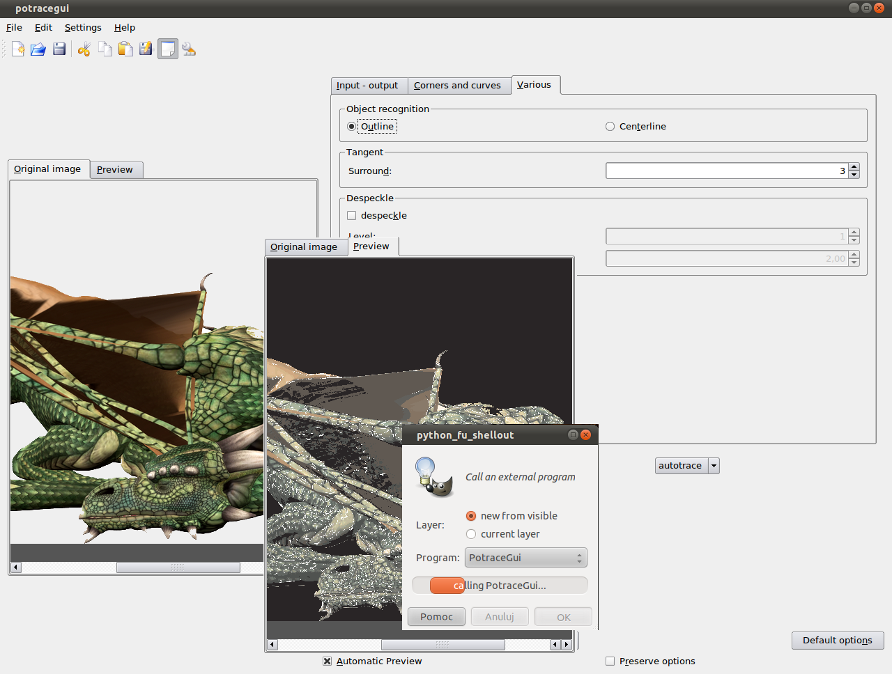

For holders of Linux is yet another old program (but it works in Ubuntu 11.04)
Potracegui
http://pkgs.org/debian-lenny/debian-main-i386/potracegui_1.3-2.3_i386.deb.html
http://pkgs.org/debian-lenny/debian-main-amd64/potracegui_1.3-2.3_amd64.deb.html
The Gimp (ShellOut) can only be indirect call - then copy -> paste
