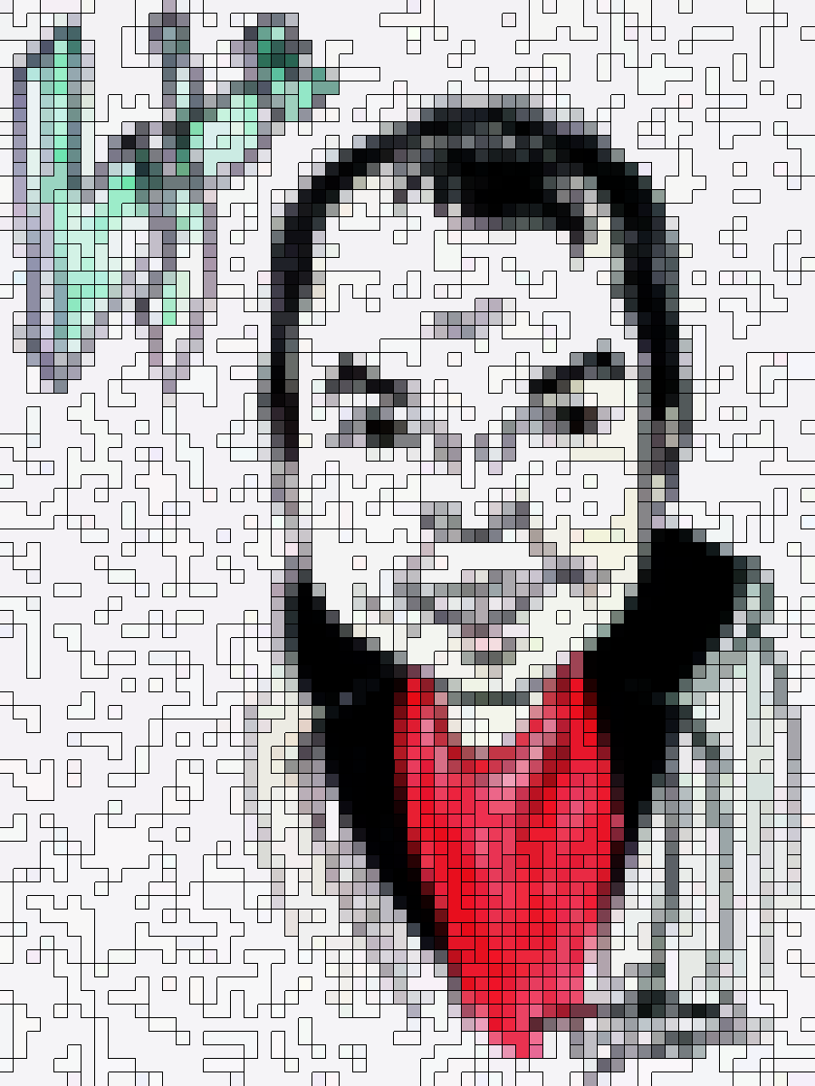

I know GIMP# can create these, but I couldn't find a PS or GIMP filter that can do so. If anyone has a clue, I'm all ears. lol
Anyway, found this site: http://ministeck.net/
It allows you to upload an image then create a ministeck render. Pretty limited. I uprezed to get this size. Would definitely like a PS or GIMP plugin or GIMP action that could create these. :)
