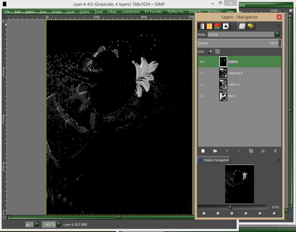

Unlike built in CMYK support that you have with PS, GIMP doesn't directly support embedded CMYK. There was talks about doing so many years ago, but it was decided that RGB was good enough. You can decompose your image to CMYK channels, but that's as far as you can get with the GIMP. Decomposing does allow you do create templates which might be good enough for offset printing firms. :)
 Post subject: Re: I need to make images in CMYK
PostPosted: Sat Jun 06, 2015 2:05 am  (#3)
Posts: 12870
Example of what I'm referring to. You can convert your RGB photo image to CMYK channels. If you have each of the channels of your CMYK, you can Recompose to RGB in GIMP too; colors might be slightly off. :)
