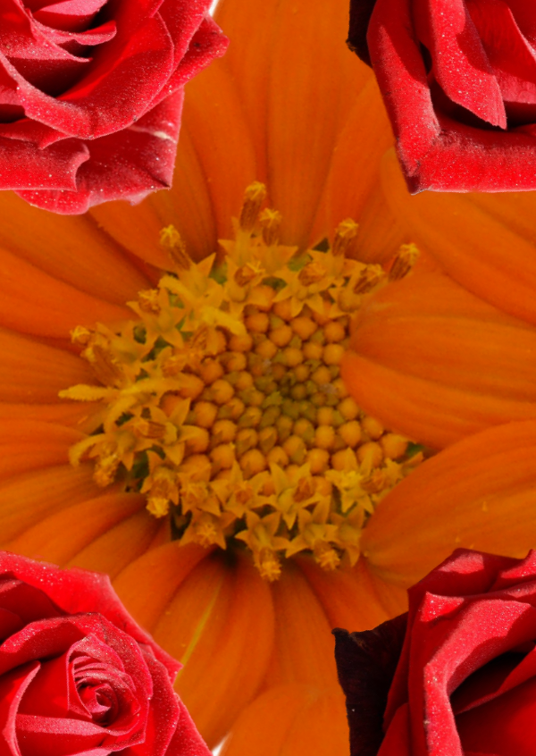

I have just acquired a few photos that I would like to make some seamless textures with. Can 'Pattern Shop' do it? If not is there another free program that can?
I know Graechan has produced a script to make patterns but they are not always seamless. Is there a way I can do them in gimp otherwise?

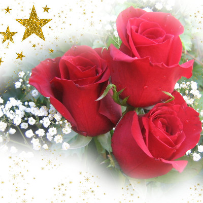

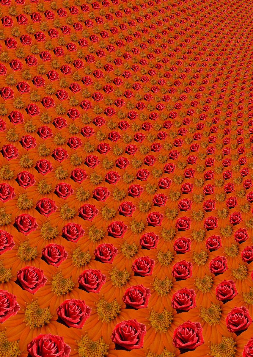

there is an easy manual way to create a seamless pattern:
1-choose any image you like but preferably render it squared
see attachment 3roses 400
2-open G'mic, go to Testing/Ronounours/Faded mirror
3-set both values to 0
4-run it once with the x axis selected
5-run it a second time with the y axis selected
you get a seamless image
6.save it as a .pat
see attachmnent 3roses pattern
to experiment create a new image and fill it with the newly created òpattern
see attachment example

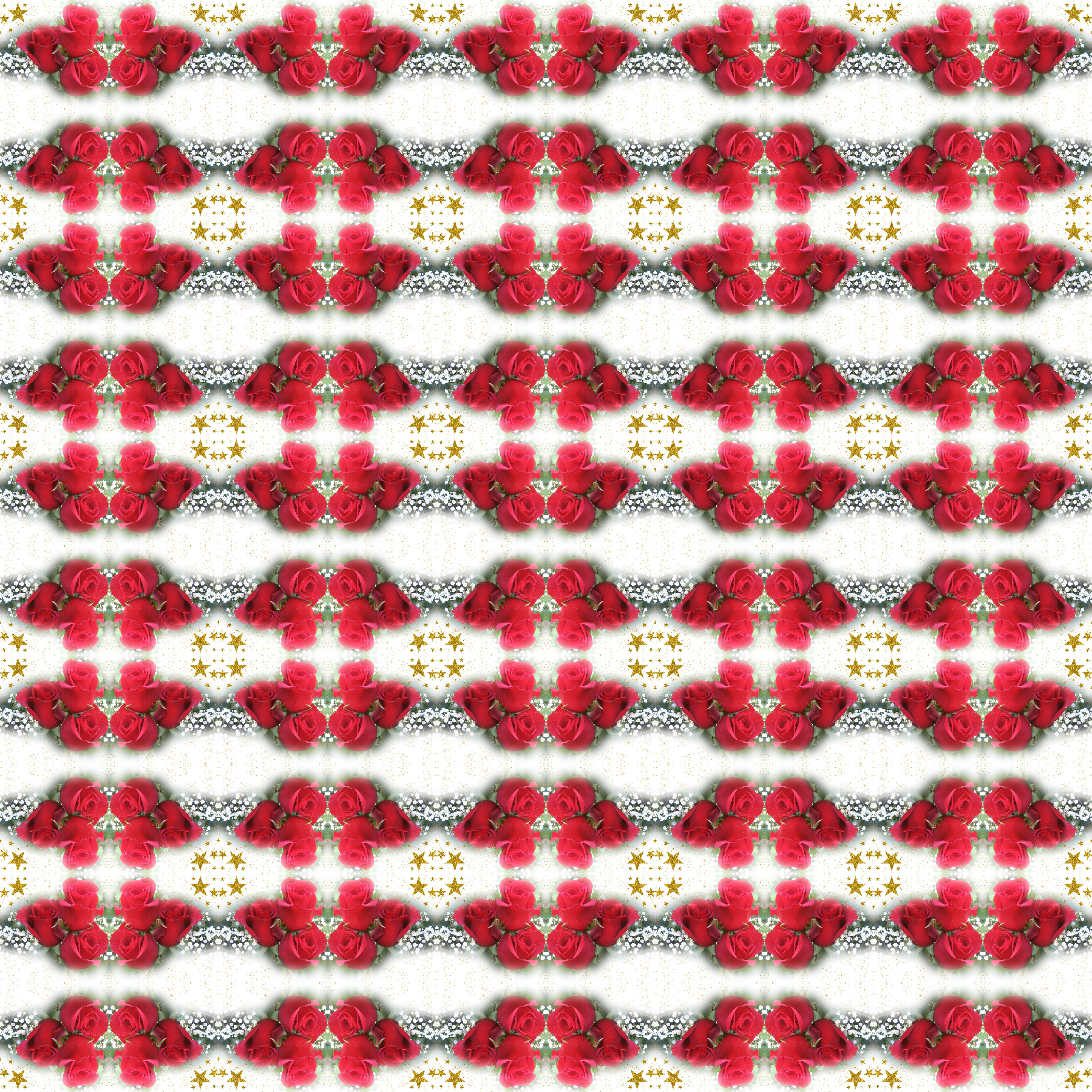

Just created this pattern Sallyanne (to be honest, I've not played with Patternshop since I upgraded to Win10. lol) in Patternshop. If you want a transparent canvas, just make sure turn of the background layer before exporting the PNG. :)
6.save it as a .pat
Very cool dinasset. It looks easy enough, I will save this for future use... thanks for sharing.
