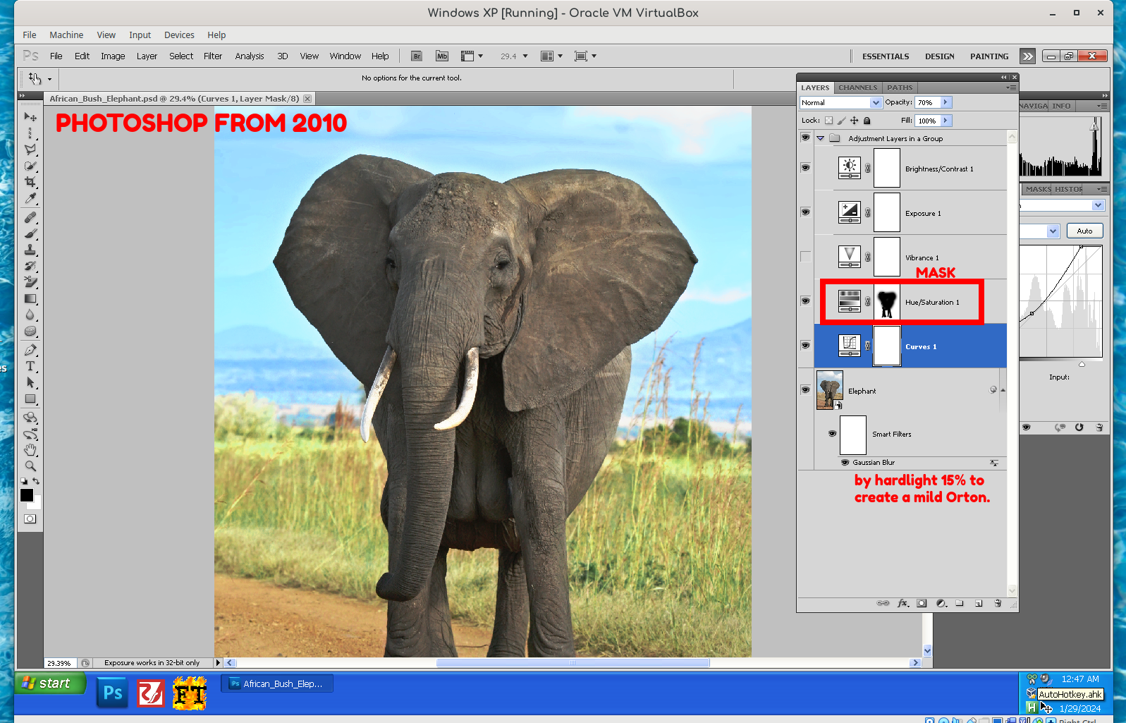

Photoshop CS5
Here is the image in Photoshop CS5 from 2010 with adjustment layers inside a layer group. Hue saturation is adjusting "Cyan" and "Yellow" and it has a layer mask to filter out the elephant. Gaussian Blur is a smart object on the hard light blend mode and 15% opacity.

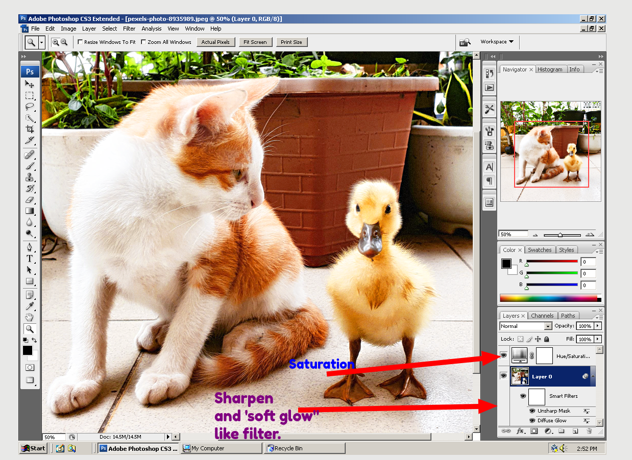

I just wasted half the day trying to install Photoshop CS3 from 2007. For some reason the version on archive.org doesn't work for me. I just want everyone to know that Adobe Photoshop CS3 from 2007 was the first version of Photoshop to have non-destructive "filter layers" for virtually every filter it shipped with Where as before only "lighting filters, transform filters, and text/outline effects" were non-destructive.
I might be able to get Photoshop CS3 working in a VM later but I don't really see the point when I have CS5 from 2010. Currently the versions of Photoshop I have are (5.5, CS2, and CS5). Attached is a journal about Photoshop CS3 from 2007. I underlined what is going on in the image.

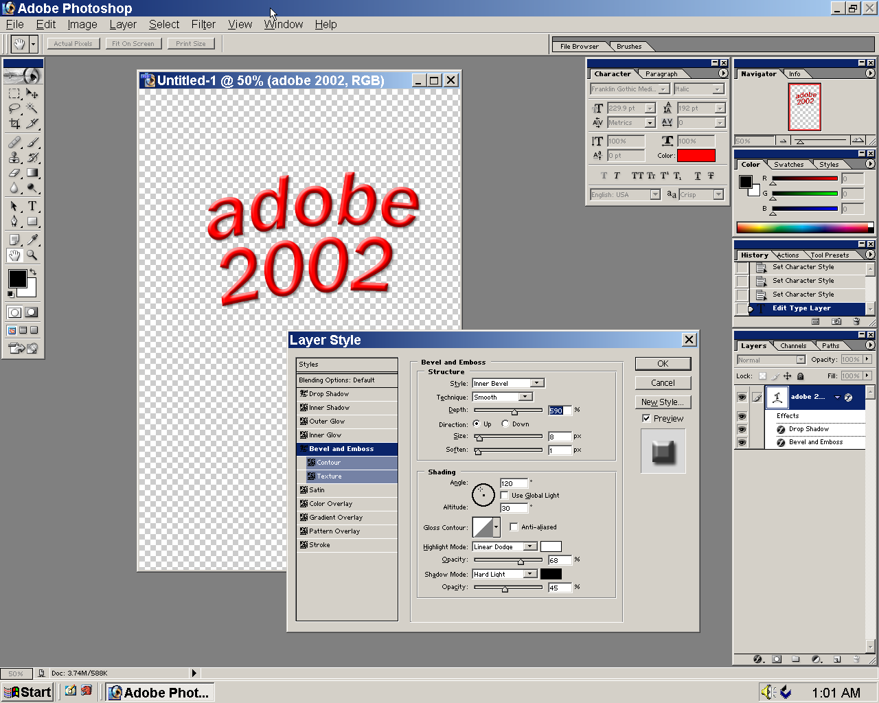

This is Adobe Photoshop 7 from 2002 doing red bevel text in a warp option. The text is non-destructive and re-editable
In the next post I'll show how FOSS of today can "poorly" mimic this.

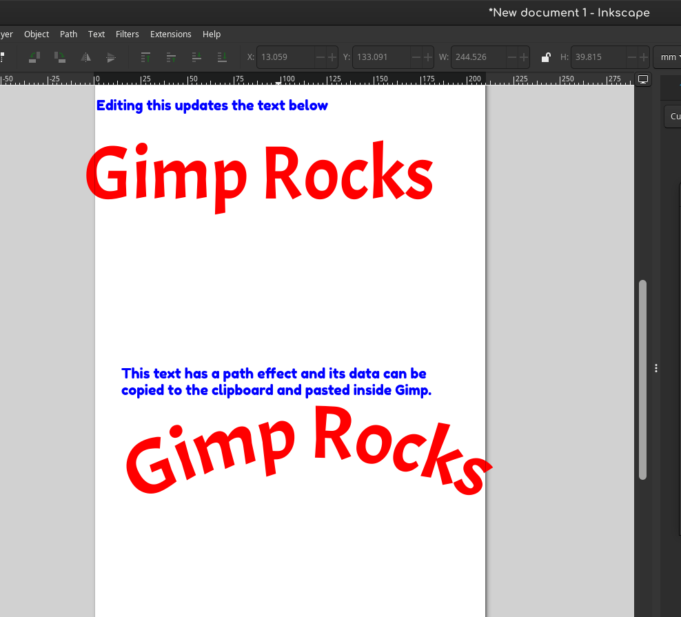

How to mimic Adobe Photoshop 7's warp text in modern open source software
The answer is Inkscape and reading about path effects and cloning text. You can read about this here starting at post #4 by Paddy_CAD
https://inkscape.org/forums/beyond/text ... ath_keFIZ/
Here is a picture of me using a cloned layer and path effects in Inkscape
The clipboard data is then pasted into Gimp then I apply my GEGL layer effects plugin
Yet, isn't it a shame that Adobe from 2002; or perhaps earlier does something Gimp from 2024 can't do? I think Adobe from 1998 can do this as well.

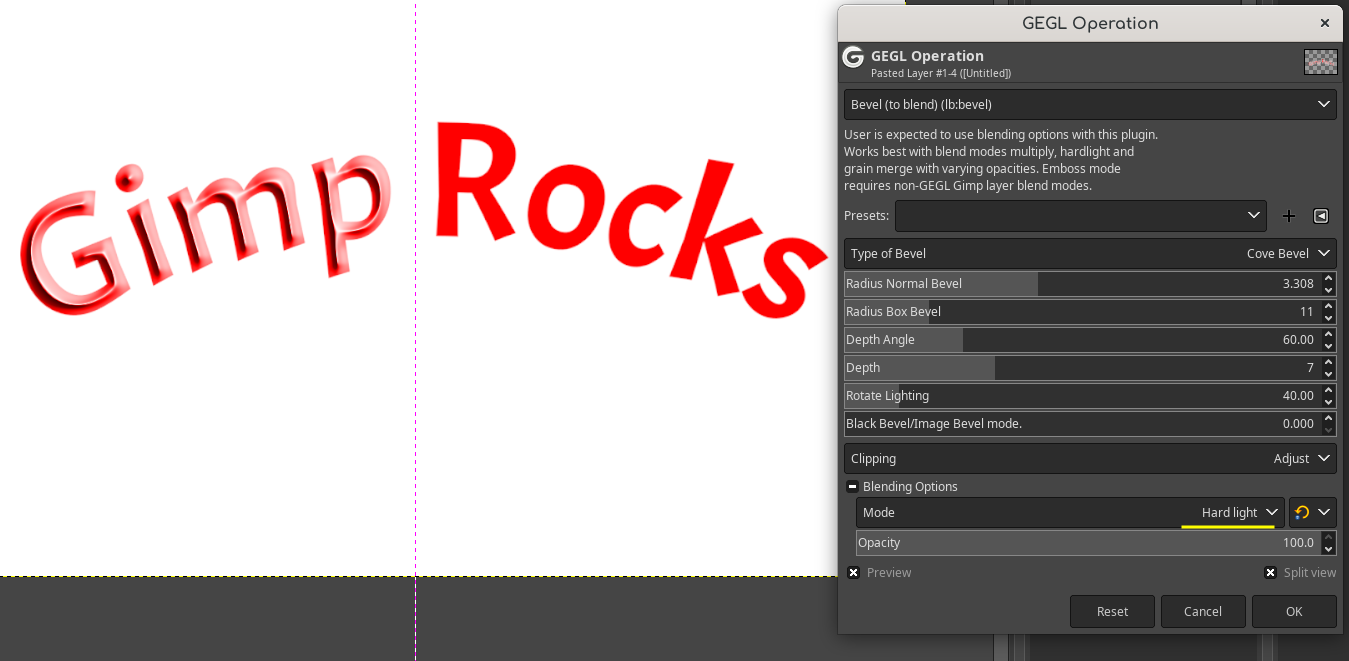

Inkscape is creating a bend text effect that will be clipboard pasted into Gimp
Now we can to apply my plugin "bevel" and test its new mode named "cove". Cove was added in October 2023. You can get the update by upgrading GEGL Effects and the stand alone bevel operation will feature the new mode.
https://github.com/LinuxBeaver/GEGL-Eff ... L/releases
GEGL Cove Bevel by hard light being applied on the warp text Inkscape generated.
I am fully aware Gimp's path tool can also do this but it is so much easier with Inkscape. One can even save the svg file of the text inside the folder they are working on.

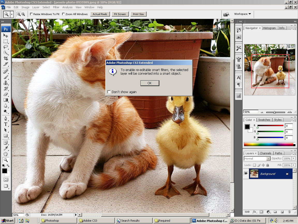

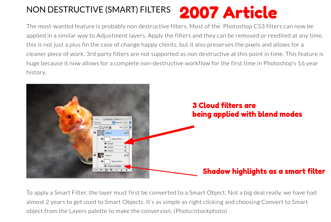

I got the 2007 install of Adobe Photoshop working and it is 100% non-destructive but has limitations such as the fact that color and lighting filters must be adjustment layers and not smart objects. Pixelitor does not have this limitation.
It says "To enable re-editable smart filters, the layer must be converted into a smart object" So lets do that.

Smart Objects (re-editable filters in 2007 Adobe)

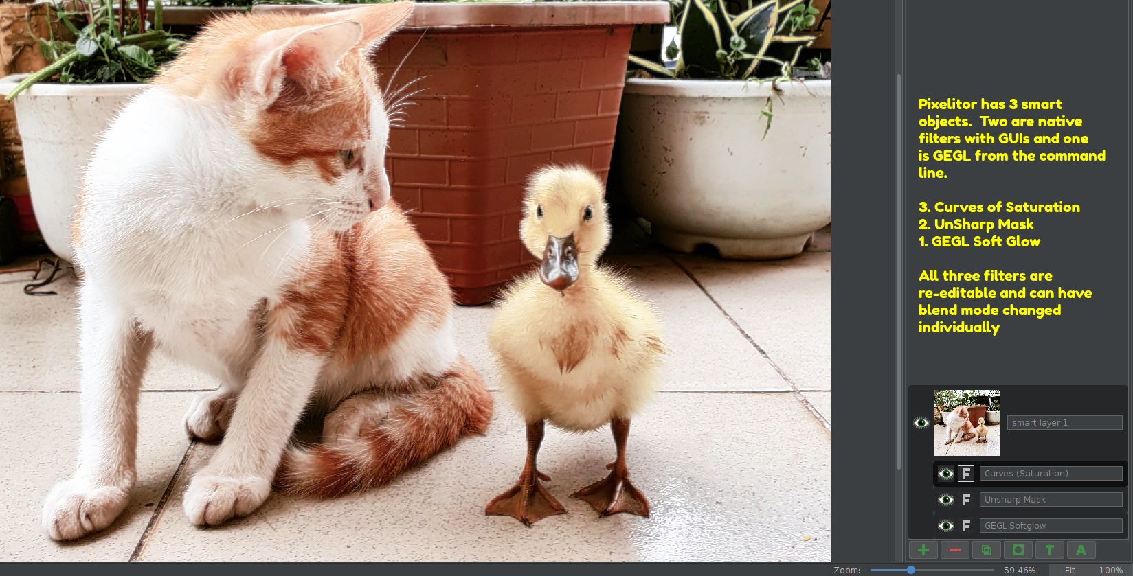

Let's try to mimic this workflow using an open source program called Pixelitor which also has smart objects. We don't have exactly the same filter as Adobe's Diffuse Glow, but we'll make do with GEGL Soft Glow.
https://github.com/lbalazscs/Pixelitor
Looks like Pixelitor of today can compete against Adobe from 2007.

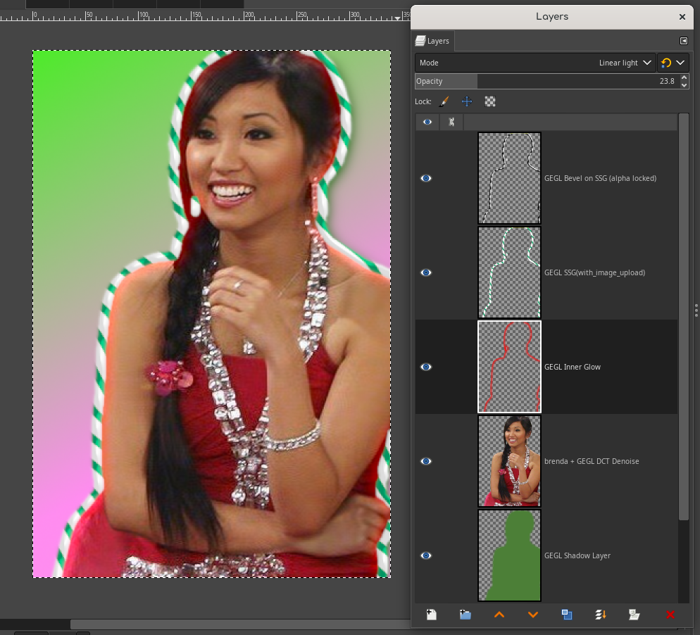

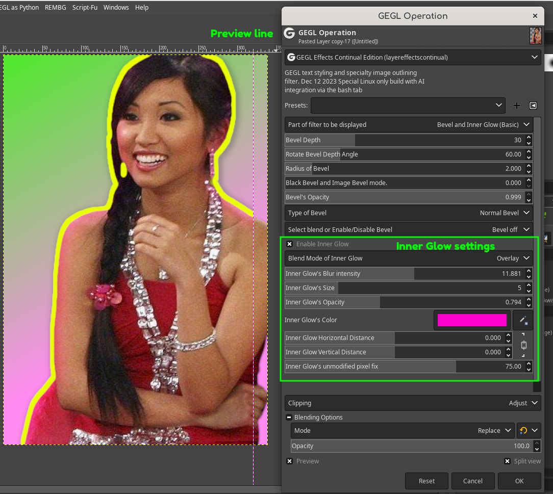

In Classic Photoshop
Layer Effects in 2007 Adobe Photoshop showing a yellow outline and shadow with pink inner glow on the overlay blend mode.
In Gimp
GEGL Effects in Gimp doing the same thing
In Gimp using individual layer effects plugins of mine (I ran dct-denoise to smooth her image)
viewtopic.php?f=9&t=20507

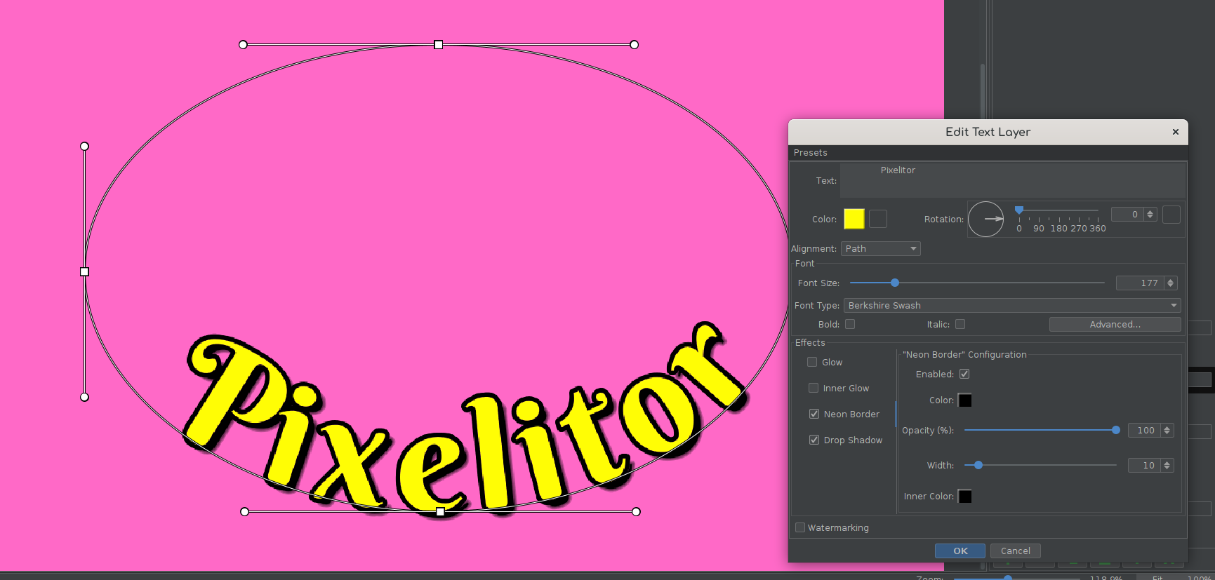

An hour ago Pixelitor's dev build updated with the ability to do editable, non-destructive, text on path.
Only one path per composition though.
Pixelitor can now do in 2024 what Adobe Photoshop could do in the turn of the 2000s

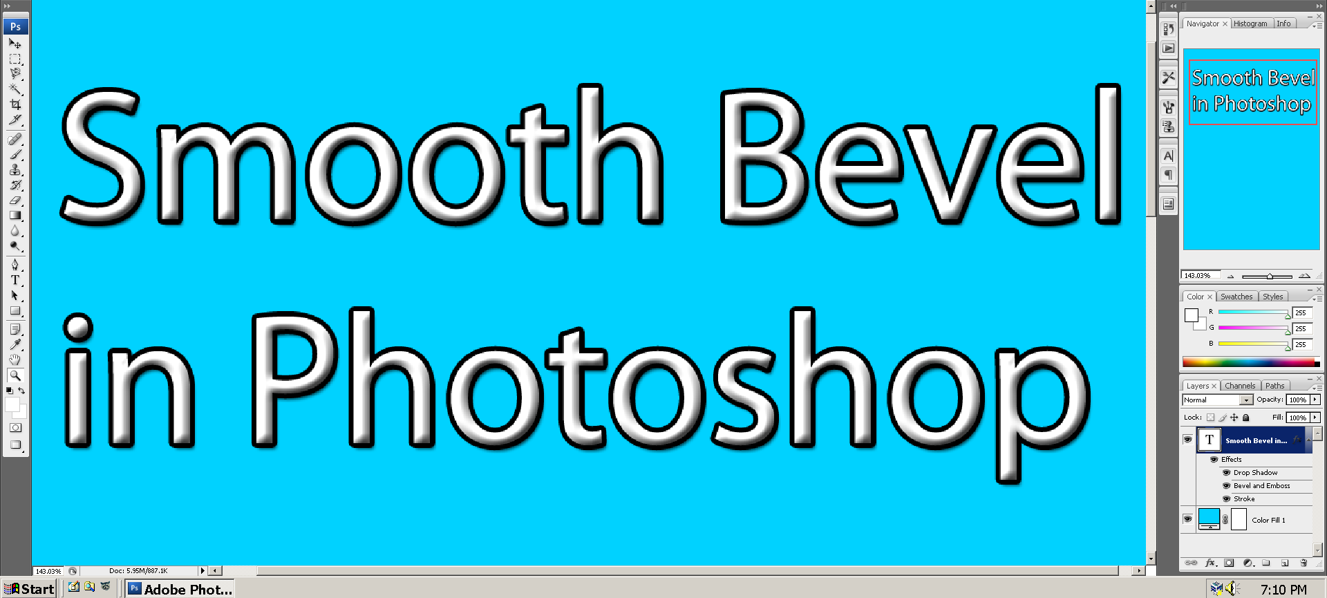

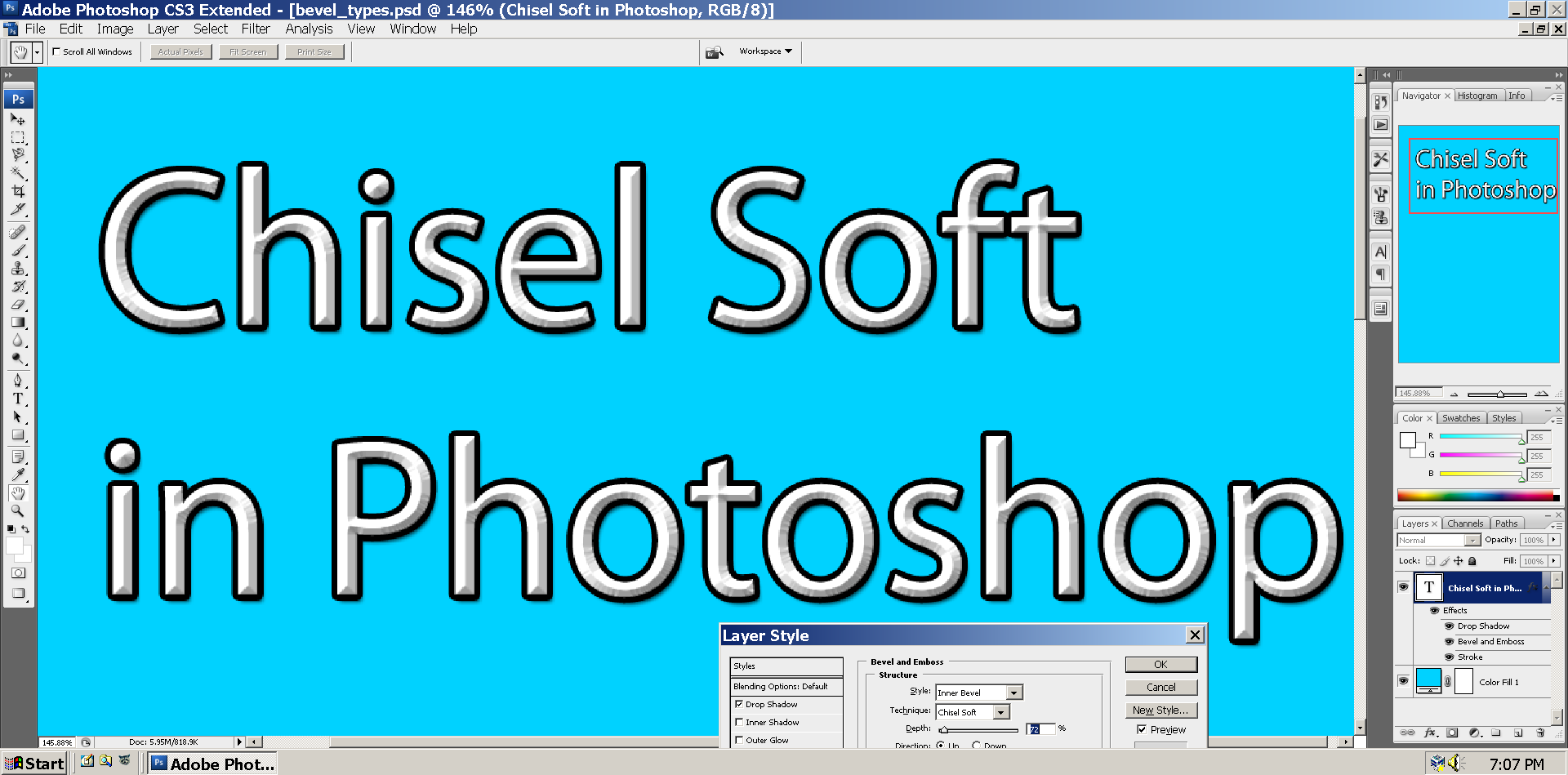

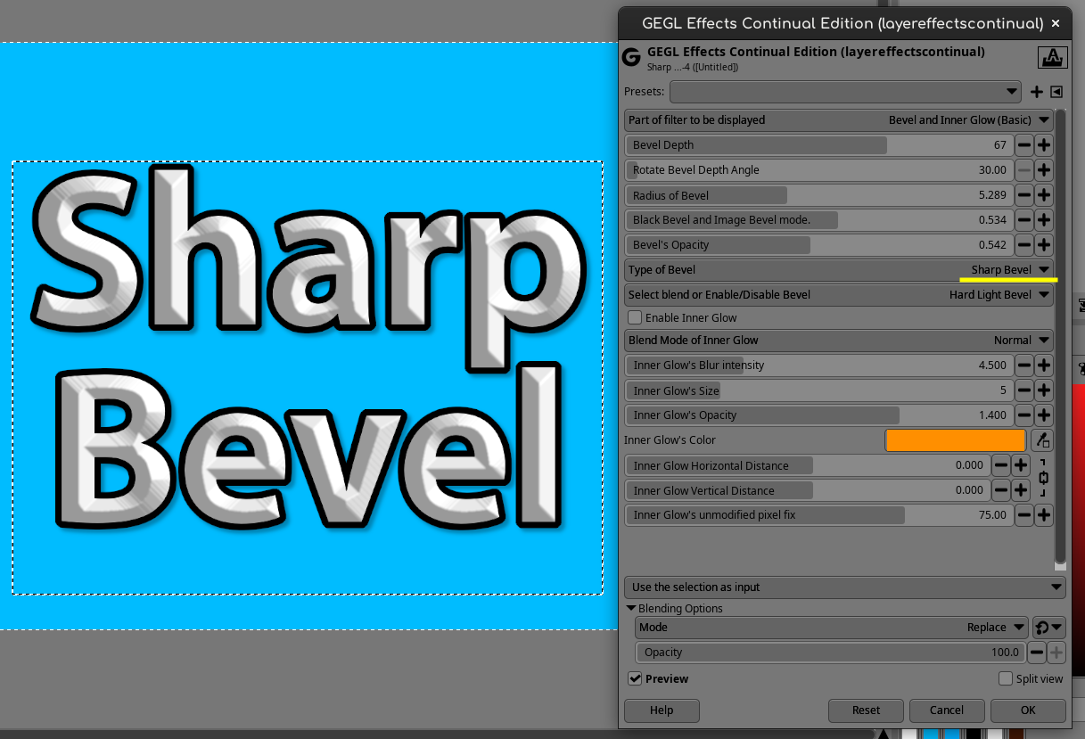

Chisel Soft and Smooth Bevel in classic photoshop are counterparts to Sharp Bevel and Normal Bevel in GEGL Effects (and my other plugins)
Chisel Soft Bevel in Photoshop resembles my sharp bevel algorithm
Sharp Bevel in GEGL Effects
Smooth Bevel in Photoshop
GEGL Effects contains a bevel mode and a stand alone bevel plugin that has normal mode and sharp mode. Normal is the counterpart to 'smooth bevel' and sharp mode is 'chisel soft'. I also have stand alone plugins that do both effects here.
GEGL Effects that contains both effects together and a stand alone bevel plugin
