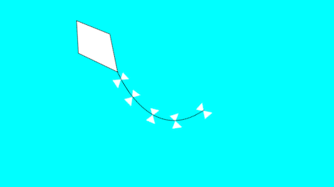

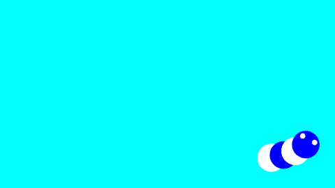

Couple of animated path (Synfig calls them Splines) animations. I am a fan of minimalism and while some animations can be complex, I like using simple figures to represent them. One of my favorite animations is Simon's Cat, which can be seen on youtube. A simple black and white animation, but it gets the point across quite nicely. Enough philosophical rambling though. Here are the animations:
Four circles follow a path. Figuring out how to accomplish that in Synfig took me a long time. The hard part to figure out is how to keep the circles even spaced throughout the animation. I was able to use a position value in the keyframing elements to do this. Of course on the other hand, once I understood how to do that, I could use that knowledge to make the circles separate and come back together as they travel along the path. Sort of like a slinky effect I suppose.
The above is the sixth version of this animation. I arrived at it after tweaking things and adding other elements including some color. Here is the original form of the animation:
In the original animation, the tail expands and contracts too much. Unless you are using a bungy cord on the tail and have a stiff wind, it should remain relatively the same length. In the sixth version shown above this one, the tail still needs some work.
I have included a ZIP file with the Synfig sifz files for anyone wanting to play around with either animation and maybe add some tweaks of your own if you wish.
