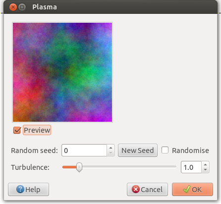

Still with this layer selected Go>Filters>Render>Clouds>Plasma and run the default settings.

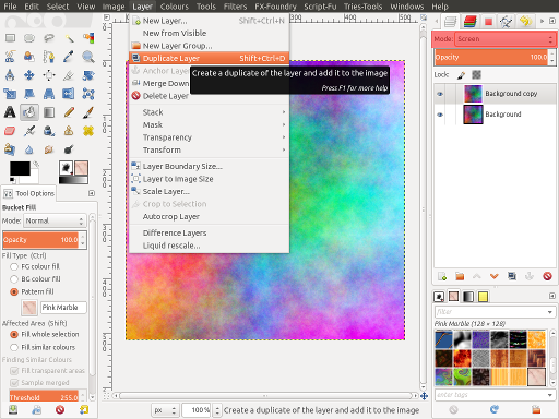

Go>Layer>Duplicate Layer and change the new layers mode to "Screen"

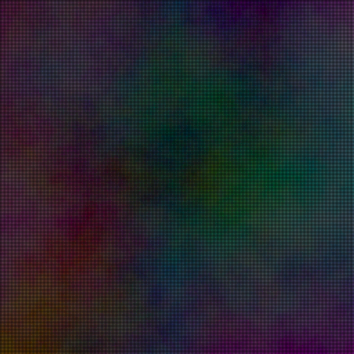

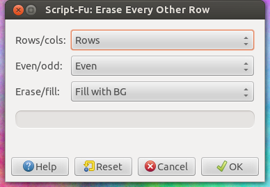

With This layer Selected Go>Filters>Distort>Erase Every Other Row and run Filter with the settings shown below
Then run the filter again but change the top setting Rows/Cols to Columns, you should have three layers and an image similar to mine below.

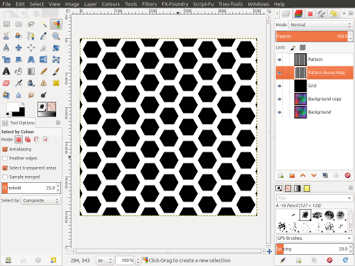

Go>Layer>New Layer and call this Layer "Pattern Bump Map" and fill layer with white.
Make sure your colours are still set to F/G White and B/G Black Image

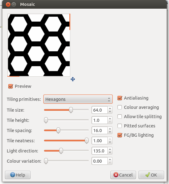

Go Filters>Distort>Mosiac, Run using settings below.
Go Colours>Invert, Go Layer>Duplicate Layer and select this new Layer, Right Click on the Layer and select "Edit Layer Attributes" rename Layer to "Pattern".
You should be looking similar to my image below...

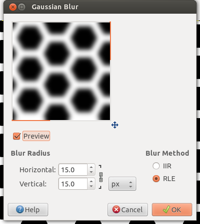

Select the Layer Named "Pattern Bump Map" and go Filters>Blur>Gaussians Blur, set X & Y to 15 and click ok. Then Click the eye Icon next to layer to turn the layer off.

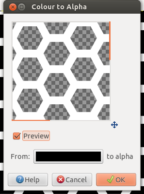

Select the top Layer "Pattern" and Go Layer>Transparency>Colour to Alpha set colour to Black and Click O.K

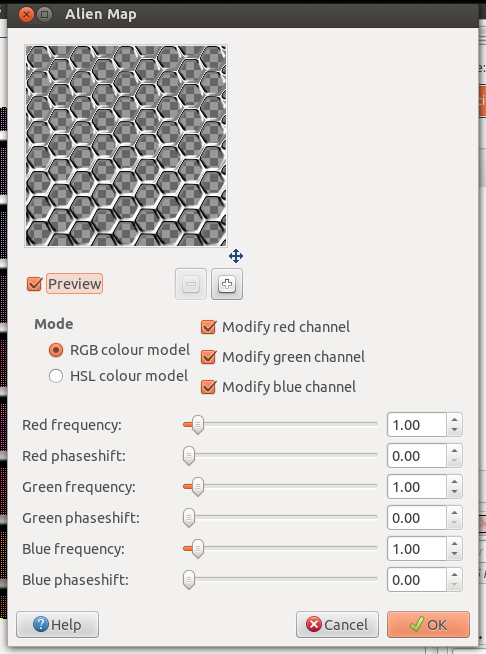

Next we are going to add some more shine to our image to make it look more like Metal, Still with the Layer named "Pattern" selected Go Colours>Map>Alien Map and with settings as shown below click O.K.

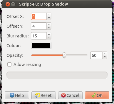

Lastly we want to add a drop shadow to our Hexagons, Still with the Layer named "Pattern" selected Go Filters>Light & Shadow>Drop Shadow and run with settings below, the important setting is to make sure "Allow Resizing" is unchecked.

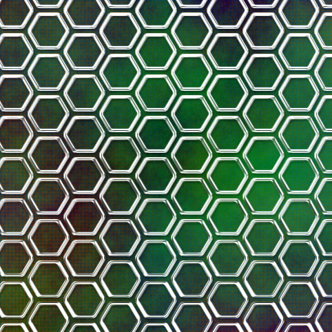

Thats it you should have a final layer set up and image similar to mine below,

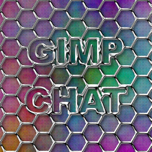

As to a text effect, below is the idea I had of using the pattern....

That is cool he4rty...how did you get the text in the centre. :oops:
