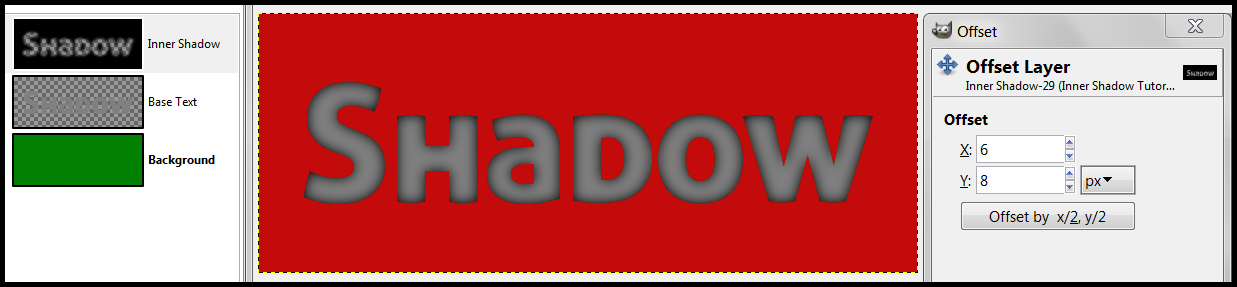

7. Now as i said in the beginning, an Inner Shadow is often offset, but how can we judge what offset looks good if we cant see the textboundaries ?
Turn on your channel and change the color of the mask that will provide good contrast OR
has the same color as your background (i used red for contrast).
Use the 'Move Tool' or the Offset Dialog (Layer → Transform → Offset or CTRL + O) to move your Inner Shadow layer.
If you applied a Bevel before, you should use the same Azimuth (angle of light) to make your 3D look convincing.
The simplest method is clicking your Inner Shadow layer with the 'Move Tool' and then using the Cursor Keys.
I used 6px to the right and 8px down.
In your offset Dialog, thats 6/8.
Note how you instantly get a 3D-ish effect.

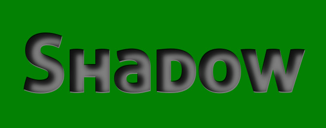

9. To get rid of everything that is outside the textboundaries, right click your Inner Shadow layer and choose 'Channel'
Thats your basic Inner Shadow (no Offset in this example).

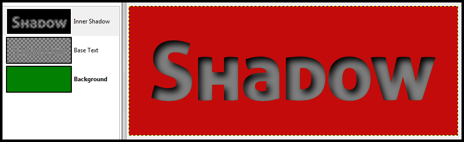

Here you can see the same Inner Shadow but with an Offset of 6/8:

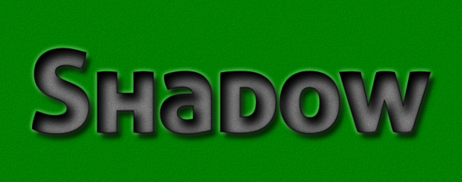

To make our final example a bit more interesting, i added a dropshadow, an outer glow and a stroke.
The text layer got noise and the background a bit of bumpmapping.
