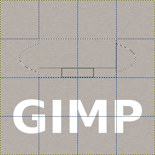

9. Select the text tool :text, I'm using settings below but you may need to adjust depending on the font you choose and the text you enter, I've typed "GIMP".
10. Go Layer>Autocrop layer then select the :move Move tool and position layer as shown below, go Layer>Layer to image size.
11. Go Layer>Transparency>Alpha to Selection.
12. Go Select>To Path then Select>None.
13. Create a new Transparent Layer.

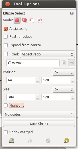

14. From tool box select the :elipse Elipse Selection Tool then start to draw a selection
15. In the Elipse Selection Dialogue Window enter the values as shown below.
16. From tool box select the :rectsel Rectangle Selection Tool, In the Rectangle Selection Dialogue Window, change mode to :addcur Add to Current Selection.
17. Then draw a Rectangle Selection, see image below.
18. Fill your Selection with White, then Go Select>To Path then Select>None.

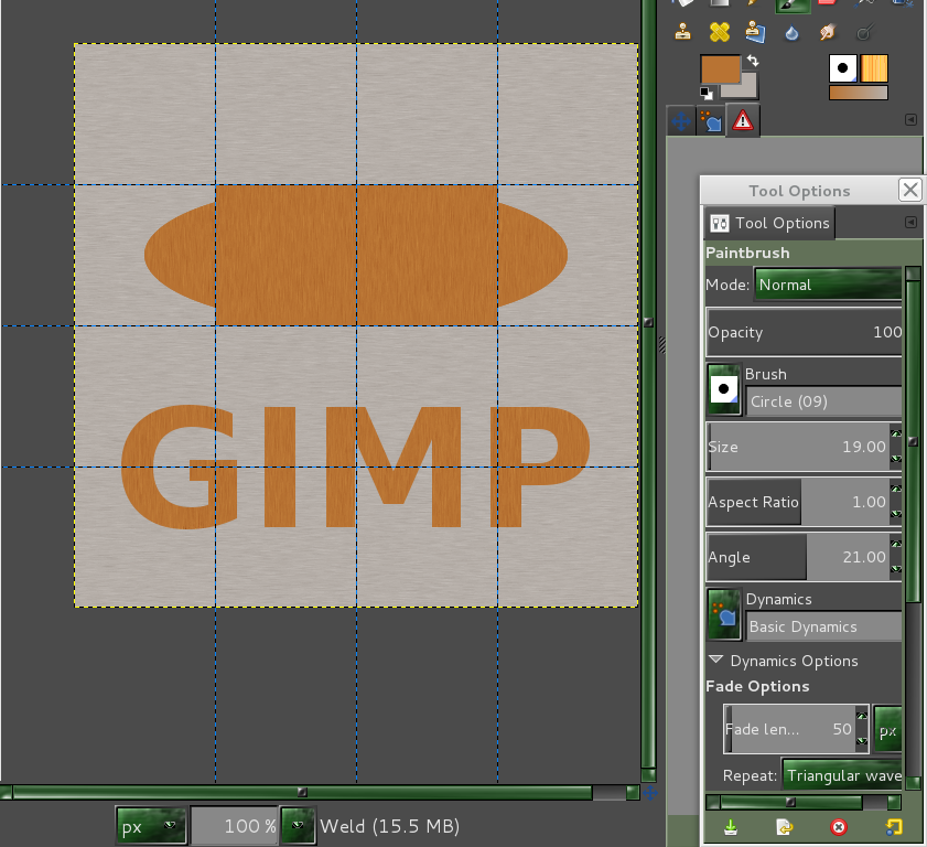

30. Go to your Brush Dialogue Window and select the brush Circle 19(21*21)
31. Change spacing of brush to 10.5, this is the brush size 21/2.
32. From Tool Box select the :brush PaintBrush Tool and change settings to the ones shown in image.
33. Just for reference the jitter setting is the brush size 21*2 and the gradient selected is "Default".
NOTE:- For those using Gimp 2.8 hopefully this link will help with the brush settings
how-to-use-color-from-gradient-in-gimp-2-8
34. Go to your Paths Dialogue Window and select the path which contains the shape design, then select :pap Paint Along Path.
35. In the Window that pops up make sure settings are as shown in the image below then click Stroke.

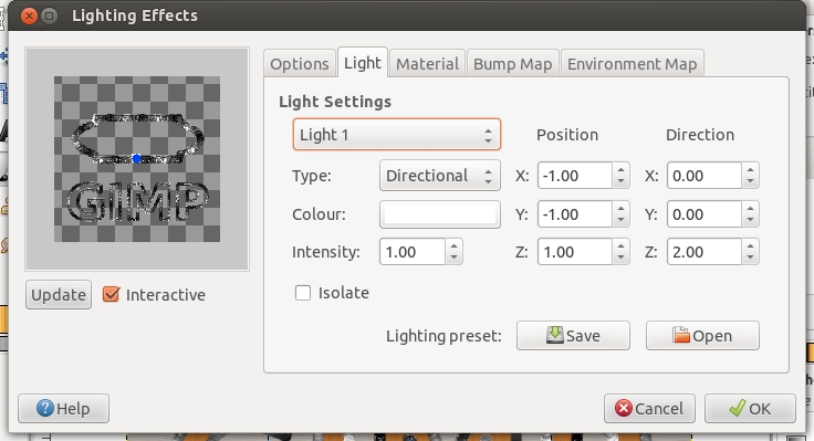

43. We need to make the weld more bumpy looking so with your weld layer selected go Filter>Light & Shadow>Lighting Effects
44. Select the tab bump, then tick the box Enable bump Mapping and make sure your weld layer is set as the bump map image
45. Select the tab Light, then change settings to those shown in the image then click OK.
46. Go Layer>Transparency>Alpha to Selection, Important point, this selection will remain for almost the rest of the tutorial.
