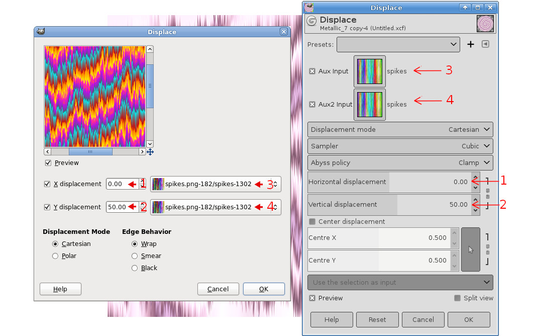

You can still do the tutorial but, as you say, Displace has changed. The old and new dialogs are pictured below with the equivalent items numbered.
To select the horizontal displacement map click on the Aux Input question mark button and double click on the layer you want. For the vertical displacement use the Aux2 Input.

Step 6. Filters > Distort > Polar Coordinates. Uncheck To Polar results in a diagonal gradient if the spiral made in step 5. was centred in the image. So I suggest you check your spiral was off centre.
That doesn't explain why your next step 7. Filters > Map > Displace did nothing. It should work if the spiral layer is the active one when you run displace and you put the first spikes layer (not the spiral one) in the Aux2 Input so I suggest you post an image of you doing that step.

Thanks again. I did this from scratch again starting with the spikes layer which I had done first before. And using a 600x600 image when I was using a big one as in 5000x5000.
Filters>Render>Noise>Plasma
The filter path seems different in 2.10 now. Also I didn't see a Plasma 2 option.
I made the spikes via that method and scaled it back to height of 600px. Looked better than what I did before.
Then made new layer for the swirl and same as I had done before added guides to get the center for the blend/gradient tool start point.
When I did the next step with polar coordinates I got the same result as before, i.e. a pattern of diagonal stripes. However the next displace step with spikes layer as both aux inputs did work.
Then I went back and skipped the polar coordinates step and went directly to the displace step and it turned out well.
So thanks again for your help on this as I got the end result but just differently.
You get diagonal stripes if the spiral made in step 5. was centred in the image. So the tutorial says to make the spiral off centre. Step 5. says:
Oregonian wrote:
Near but not exactly on the center of the image, drag down a short distance.

Hey thanks again. Yeah I thought I was supposed to center the spiral start point. Missed that it was necessary to be a bit off vs Oregonian just saying what he did.
