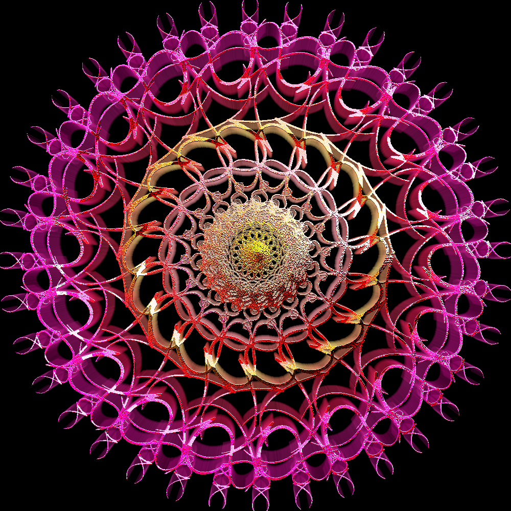

Regular Gimp Chatters know I am obsessed with mandalas. Erisian's original thread was based on using Symmetry Painting, which originally did not work for custom brushes. Now it does so here is a demo tutorial in which I create a custom brush using Ofnuts 'path inbetweener' plug-in and then a quick mandala using that brush.
PDF file tut is attached below along with a resources file including a starter xcf file with the layers and paths, the Ofnuts plug-in and the 'fade to fade' brush dynamic, the last two of which need to be unzipped and placed into your GiMP profiles.
Here is an image similar to that produced by the demo tutorial.

Issabella and Ella Louise have highlighted in their submissions, something I forgot to point out and that is highlighting the finished mandala with additional effects, such as colour and texture. So I have posted a new one below, created as per the tutorial technique and which was originally the off white d8d8d8 colour as used in my tut, but to which I have applied a gradient, some GMIC filters and zoom blur to complete the image.
