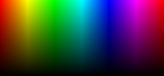

The experimenter in me tried the three methods on this rather synthetic image. What happens to the histogram is rather revealing.

Yes, there is quite a precipitous drop off in the upper thirds of the histogram! Mostly expected due to the relative amount of green (and green+red) vs. everything else.
