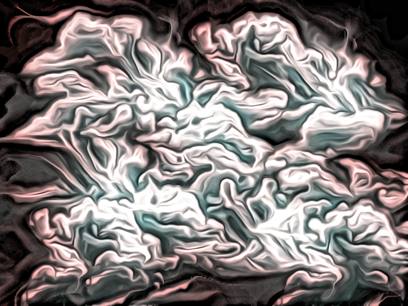

Starting image:
(This image was made using white clouds brushes on a black background, then G'MIC Graphic Novel, G'MIC Dream Smoothing and Gimp ACE.)

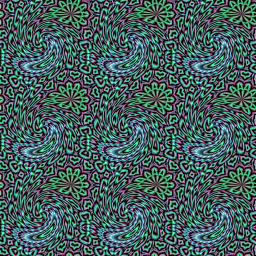

Thanks for the preset jontait2. It's been a while since I added a preset this way, but it did work and it now shows up per your post. Still, can't seem to get a decent whirl/pinch result. Regardless, adding Mehdi's Kaleidoscope to the result (after whirl/pinch) gave this result. :)

Just rename .gmic to gmic (I run GIMP in Win8.1) and then place it in the directory as you said (not the gmic directory; the one where you said) and do refresh. Done. If you can just automate the whole process; that would be cool then. Thanks again jontait2. :)
 Post subject: Re: "ancient paisley tutorial" - explanations and advice
PostPosted: Mon Jul 27, 2015 10:41 pm  (#31)
Posts: 12845
OK; figured out a few more things; then applied rotational C/L to that result. :)

PostPosted: Wed Jul 29, 2015 12:06 pm  (#38)
lylejk: you're welcome. so when will we see the endless field of whirl-and-pinch paisleys? you know that's what we all expect now!
PostPosted: Wed Jul 29, 2015 12:36 pm  (#39)
Posts: 12845
OK Anmal; included the actual tile too. Glad GIMP still works after my Win10 upgrade. lol
