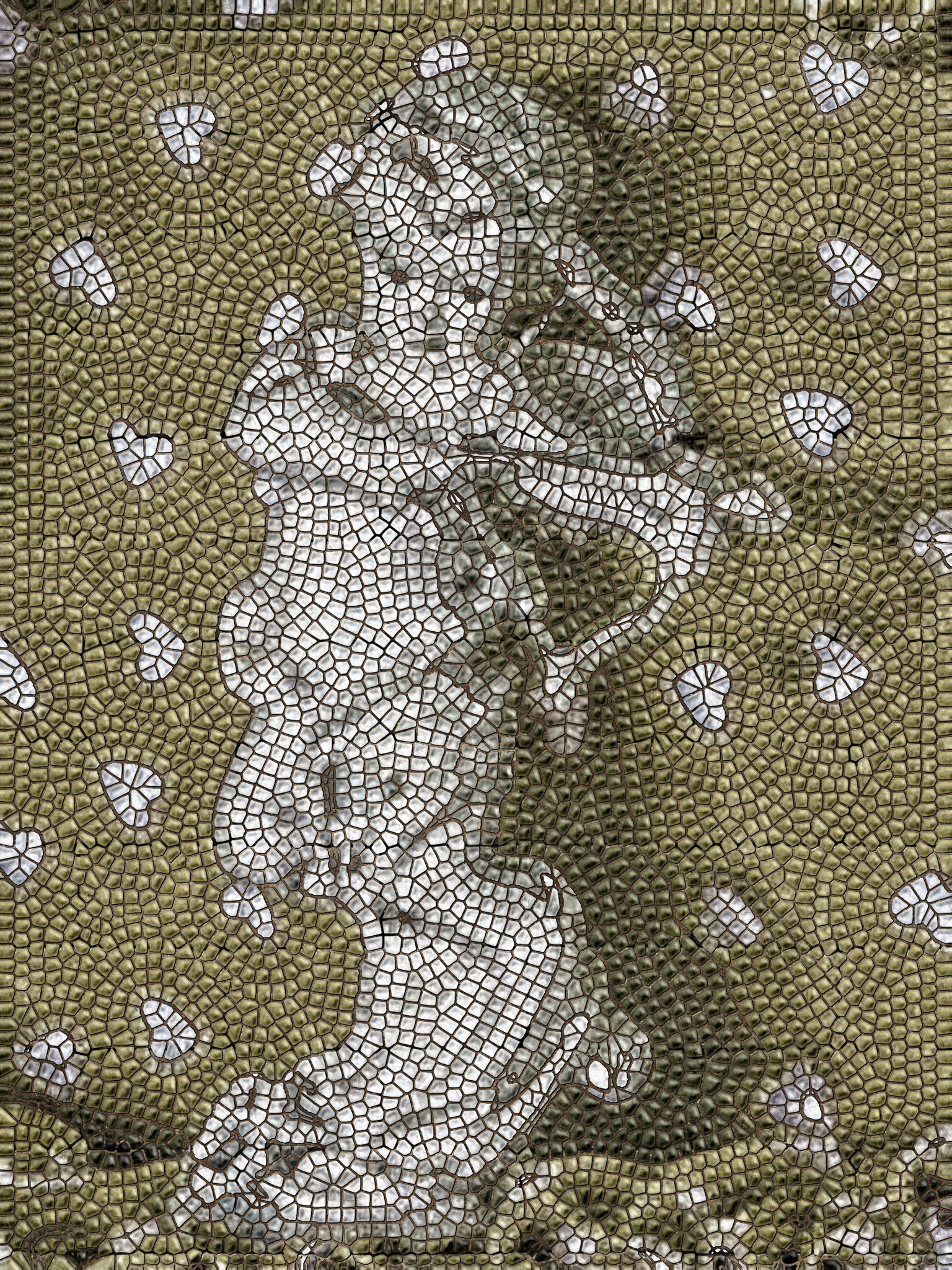

I had forgotten about a very cool Script-fu called Voronoi path. It makes a very, very (did I already mention very?) clean mask for creating the mosaic tiles (much cleaner than Skeleton). Slow as molasses though. Your dot has to be ubber clean too, so once you stroke the dot, you need to run G'MIC dither to make the dot clean. Then you need to copy this and paste it as a selection mask. Then you need to convert the resulting selection into a path. Then you run Voronoi path to create the outline that you then stroke for the mask. :)

Also, Voronoi path scales up nicely; skeleton, not so much. :)

Pat625 wrote:
Lyle: You really are the #1 Mosaic Wizard!!! I can't even begin to realize how you figure all this out
Thanks Pat; you must have ninja'd me and I didn't notice. lol
ref: http://www.fontplay.com/freephotos/4thf ... 406-10.jpg
Anyway, for this one, I actually opened up the resulting vector mask in Inkscape and manually deleted all the spurious rods (and did miss a few which I did correct by paint brushing; lol). Lots and lots of work, but a learning experience none the less. :)

PostPosted: Sat Mar 05, 2016 7:46 pm  (#40)
Posts: 12853
Ref: http://www.fontplay.com/freephotos/imag ... er-982.jpg
OK; this time, instead of stroking the path's from Mosaic helper, I just created a solid stroke and fed the result into Voronoi stippler to strategically distribute the dots. Gives more variety as far as tile size and placement is concerned imo. :)
https://www.flickr.com/photos/34520999@ ... 4/sizes/o/
