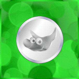

I did it! :faint
I started from scratch and carefully went through the GAP tutorial again.
I need to work more on the lettering and Wilber but just had to post my results.

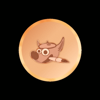

Something a little different. I changed the radius in the cylinder settings to 0.45 and the thickness to 0.05. I used the GAP spinning coin tutorial for the rest.
I don't recommend doing this because it took very close to 3 hours of processing time by the time it was finished. It used 52% of my 2gb of RAM and my processor was practically constant at 61% usage.
Very impressive O.
I'm here making my own elliptical shaped one as well, to try out your idea. Yeah, it's taking a while to process here too.
