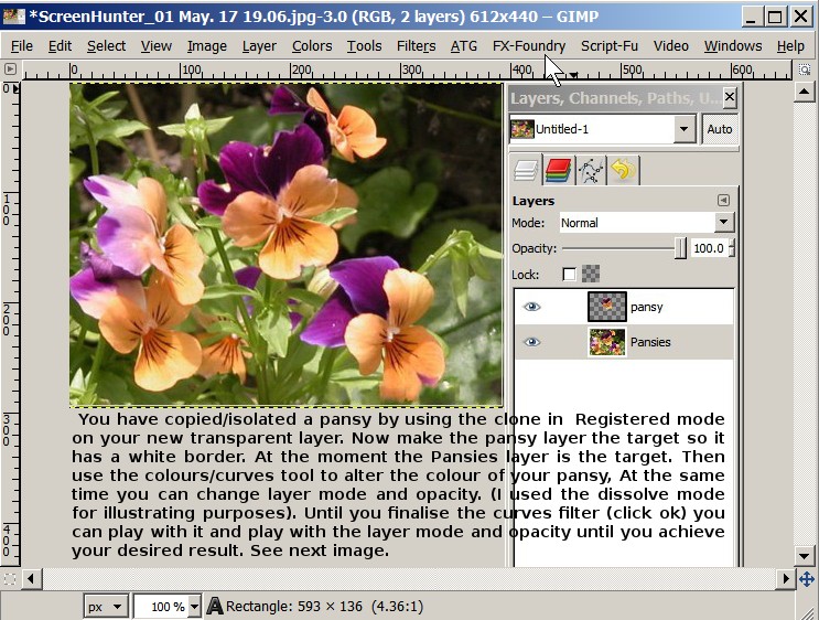

Molly, Thank You trying out the tut. An excellent example of one of its uses. What you can do now, is change one of the images (say in colour). Now use the opacity slider or layer mode to see an immediate effect of the combination of the two layers. When you are happy with your new result you an re-merge the two layers with your filtered effect.

I don't know quite what you are saying.
You say change one of the images, do you mean for me to dupe the pansy layer on the transparent layer, or change the opacity of the top layer. I am confused.
Molly, perhaps this will help. I copied your image and did the same as you
