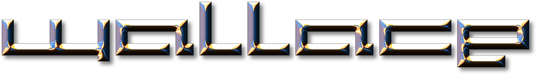

Here's one I came up with using this technique/tutorial.
Cool way of making spherical emaps and the Dinasset's Globe View script will come in handy. :bigthup

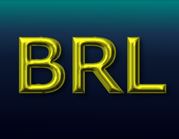

Thanks Adventure. Maybe this will help.

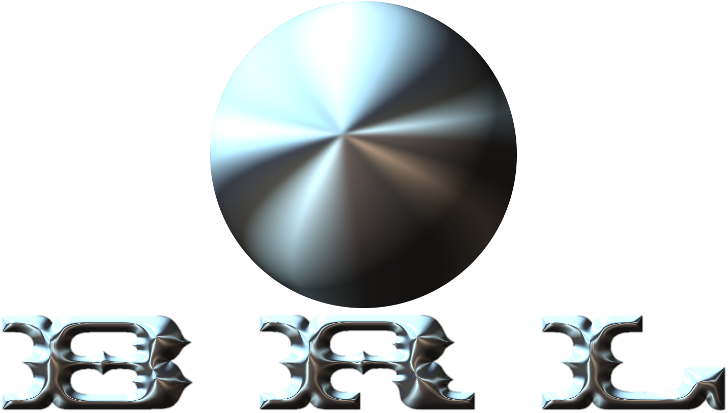

Things you can try.
Gblur the sphere before you save for a shiny finish. SEE #13.
Use a regular PNG file but increase the canvas size by 5 and center it.
And best of all, once you create a sphere, go through the tutorial again using the sphere you created. It can give give some very nice results also.

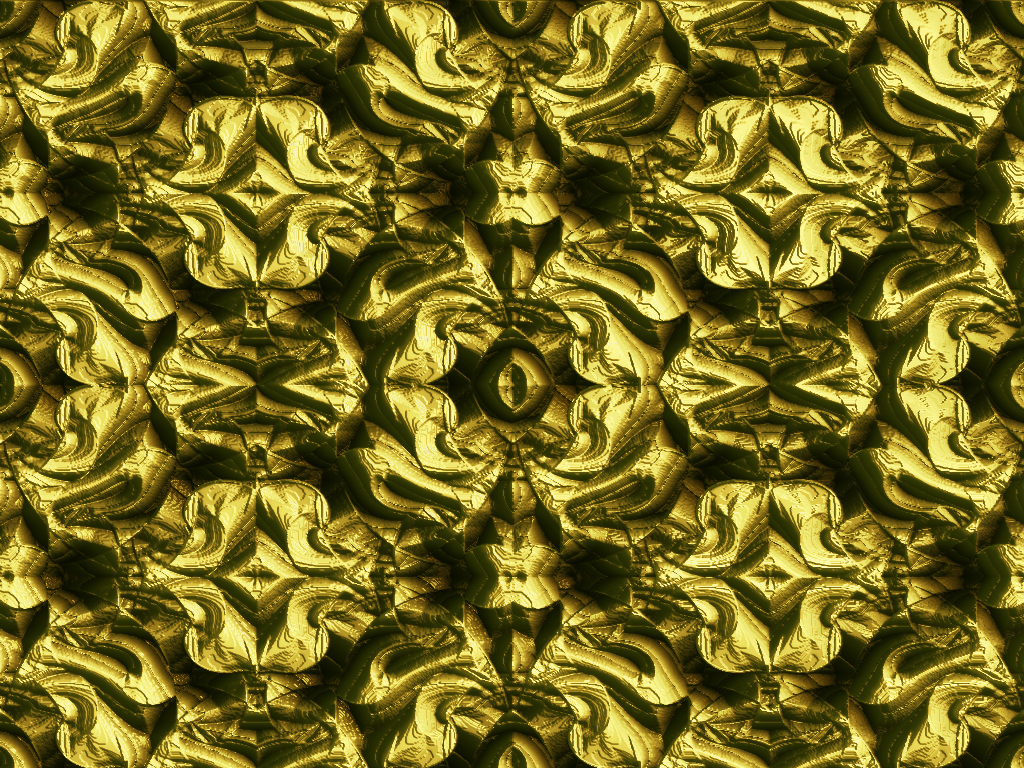

Been creating a few but this one I am pleased with, took the gradient from this wallpaper I had created but applied a different technique for the sphere.
And the results
Attached is the Map and Gradient
Grad-Brl-07.ggr [2.54 KiB]
Downloaded 326 times
