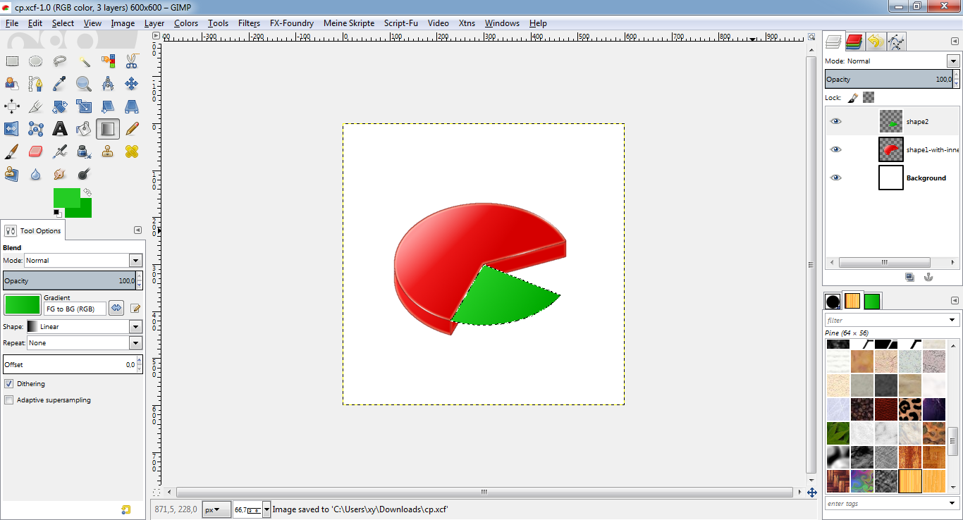

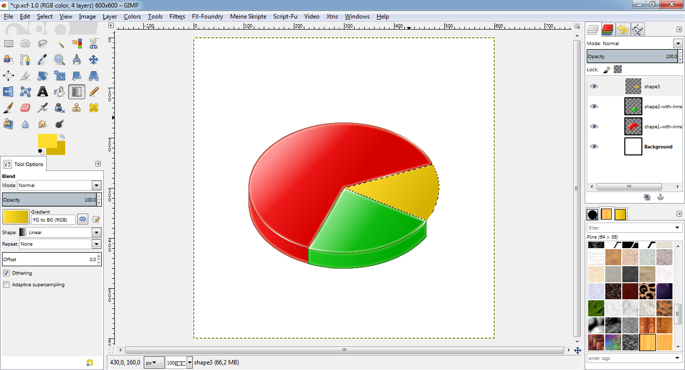

* Create a new image, 600x600px, with a white background.
FIRST PIECE
Basic shape:
* New transparent layer "shape1".
* Ellipse selection in the center (mine is 380x260).
* Select -> to path "ellipse".
* Select more than the lower right quarter of the ellipse with the free
select tool and subtract it from the selection.
* Select -> to path "shape1".
* Linear gradient fill from upper left to lower right of the selection with
FG #ff2d2d and BG #fd0000.
* This is what it should look like:

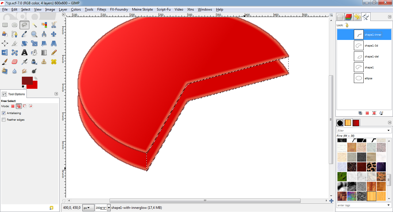

Preparation for corrections:
* Layer to image size, Alpha to selection.
* Select -> To path "shape1-3d".
* Path window: "ellipse" -> Path to selection, "shape1" -> subtract from
selection. Select -> To path "shape1-del".
* Path window: "ellipse" -> Intersect with selection. "shape1-3d" ->
* With the free select tool, add two triangles left and right to the
selection and Select -> To path "shape1-inner". (You may need to increase
the view zoom factor to max to get this as most accurate as possible.)

* Merge down all shape layers to one single layer.
You have successfully created the first piece!

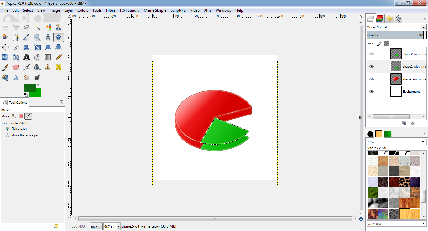

SECOND PIECE
Basic shape:
* New transparent layer "shape2".
* "shape1-del" -> Path to selection.
* Select a lower part of the shape with the free select tool and subtract it
from the selection.
* Select -> to path "shape2".
FG #24cc24 and BG #00aa00.

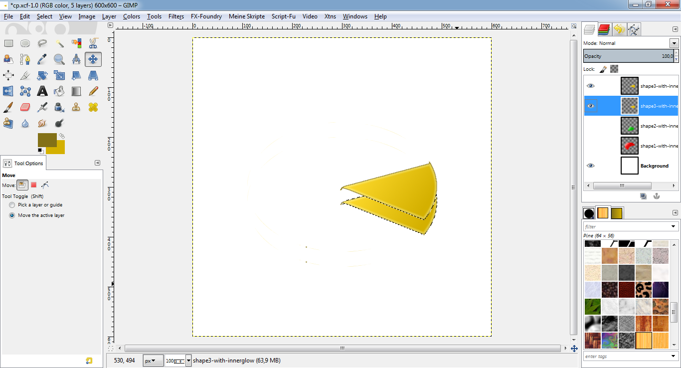

3D effect:
* Layer effect "inner glow", default, opacity 50%.
* Merge layer group.
* Stroke selection with #126912, 1px.
* Duplicate layer and select original layer.
* Move tool on "active layer". Move layer down about 30px (the same value as
used in shape1!) to create the 3D effect.

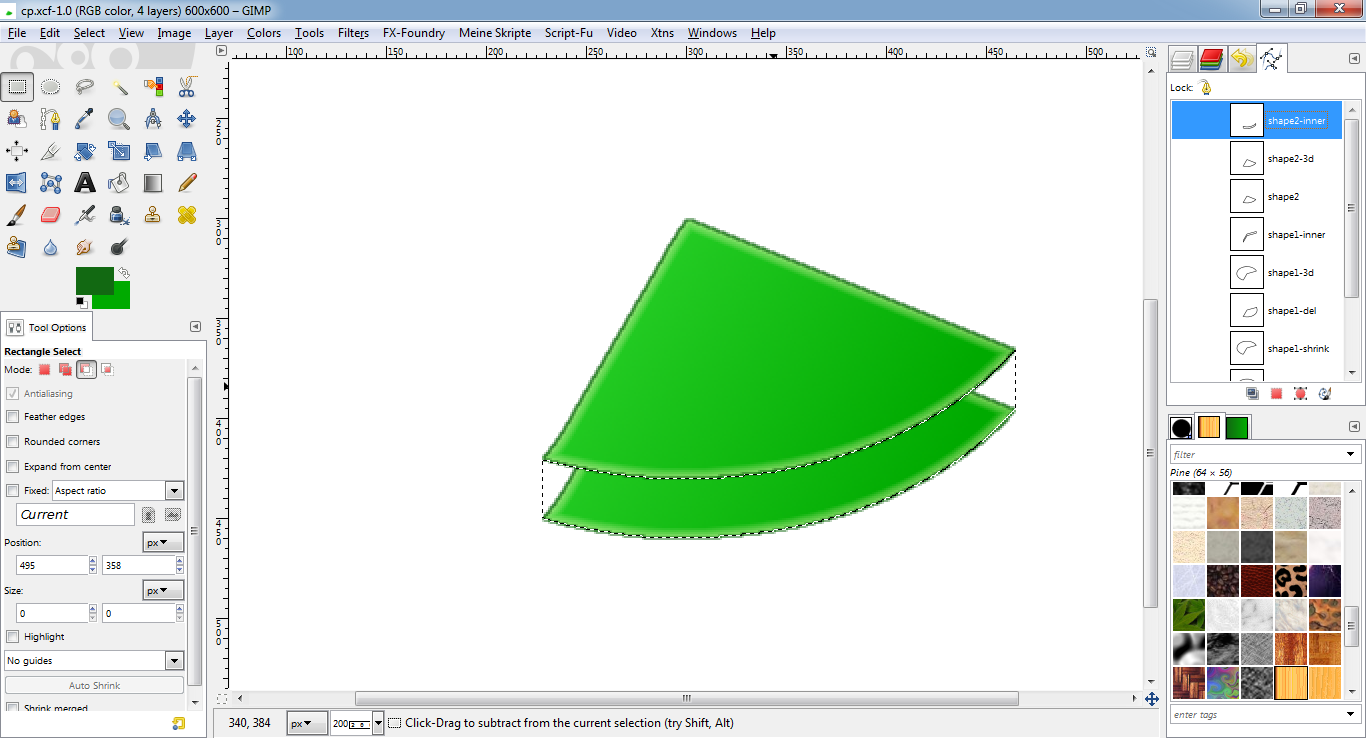

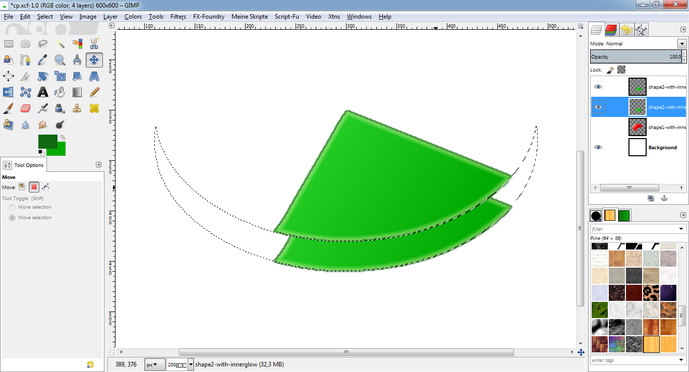

* Select -> To path "shape2-3d".
* Path window: "ellipse" -> Path to selection. Move selection down about 30px
(the same value as used in shape1!). Select -> To path "ellipse-3d".
* Path window: "ellipse" -> Subtract from selection.
* You may want to hide the shape1 layer.
* With the rectangle select tool, subtract the "noses" left and right from
the selection and Select -> To path "shape2-inner". (You may need to
increase the view zoom factor to max to get this as most accurate as
possible.)

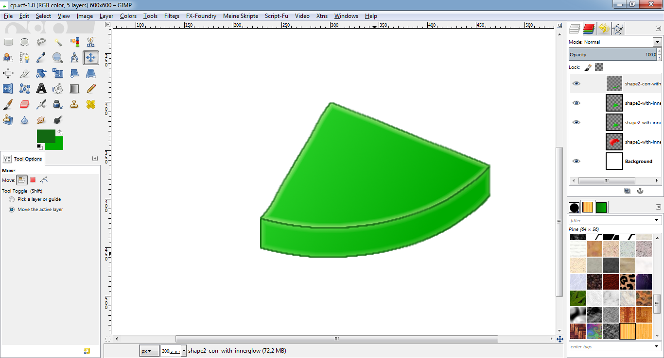

Corrections:
* New transparent layer "shape2-corr" on top of all layers..
* Apply the same FG to BG linear gradient as above.
* Layer effect "inner glow", default, this time opacity 25%.
* Correct some possible pixel errors "by hand" as above.

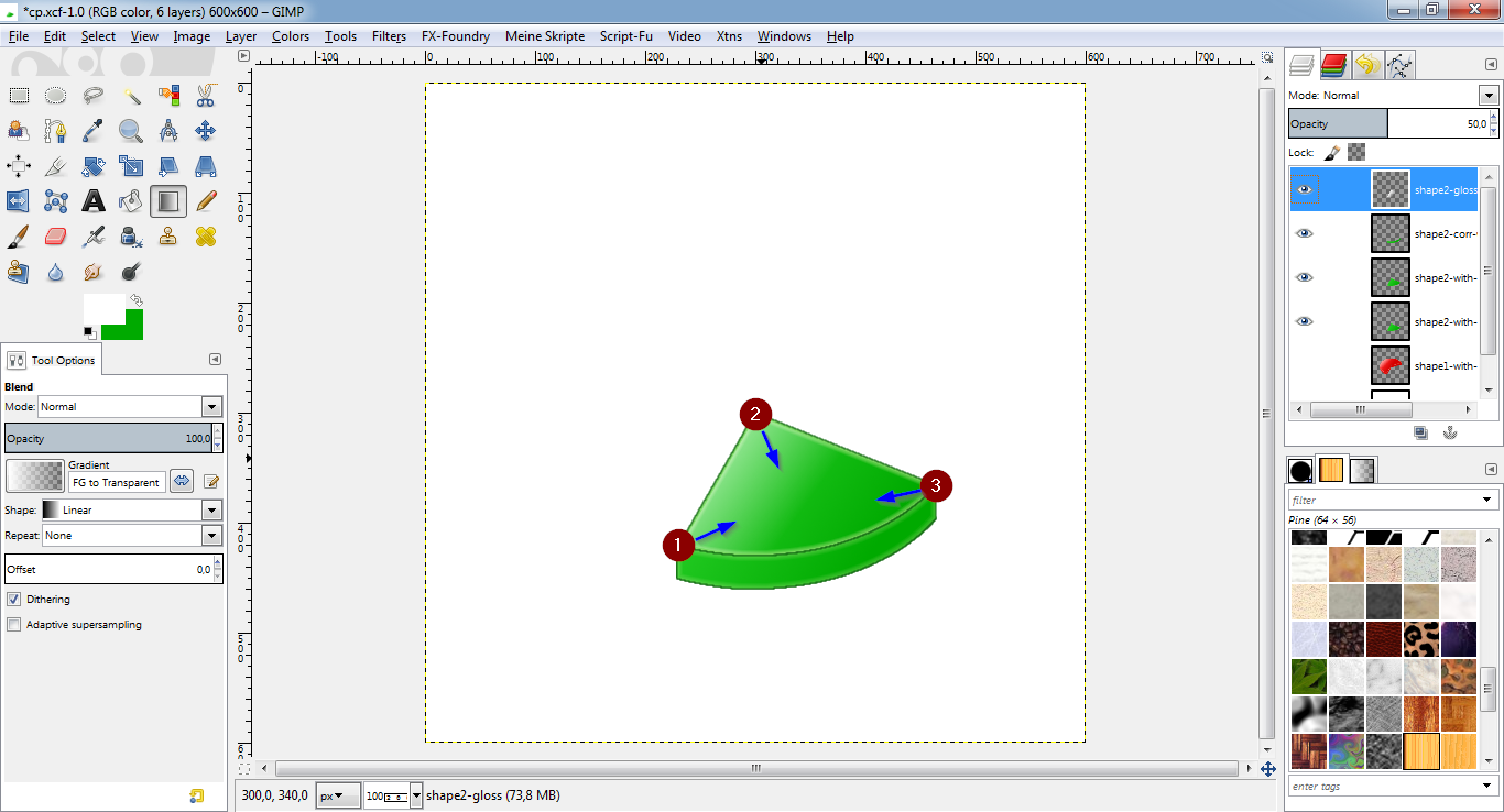

Gloss effect:
* "shape2" -> Path to selection.
* Select the shape2-copy layer.
* Select -> Shrink, 2px.
* Select -> To path "shape2-shrink".
* Create a new transparent layer "shape2-gloss" on top of all layers.
* Drag a FG (#ffffff) to transparent linear gradient like you did before, but
only about half as long. Set the opacity of the layer to 50%. You will have
to play with this a bit, until you are satisfied.
Glitter effect:
* New transparent layer "shape1-glitter".
* Path window: "shape2" -> Path to selection. "shape2-shrink" -> Subtract
from selection.
* See the following picture:
* At the 1, 2 and 3 marks, drag and drop a radial gradient, FG (#ffffff)
to transparent. Increase zoom view to max and drag just from the outer of
the selection to the inner about 40px long (see directions in the picture).
This will simulate a glitter effect and is a possible equivalent I found
to the photoshop "stroke with burn" function ;)

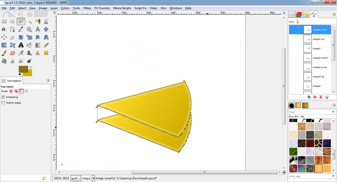

THIRD PIECE
Basic shape:
* New transparent layer "shape3".
* Path window: "ellipse" -> Path to selection. "shape1" -> Subtract from
selection. "shape2" -> Subtract from selection.
* Select -> to path "shape3".
FG #ffdb2d and BG #d4b000.
3D effect:
* Stroke selection with #837117, 1px.

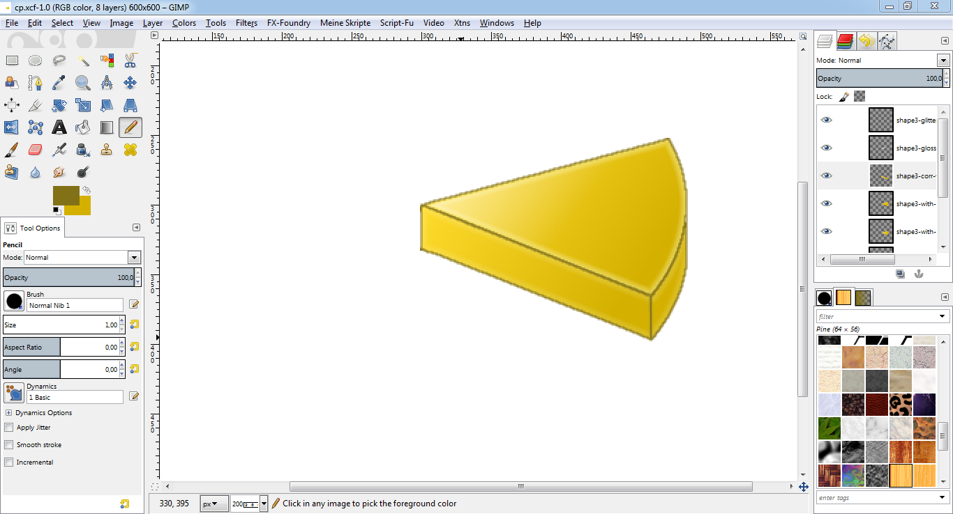

* Select -> To path "shape3-3d".
* Path window: "shape3" -> Subtract from selection.
* You may want to hide the shape1 and shape2 layer.
* With the free select tool, add the missing part on the left of
the selection and subtract the "noses" on the left. Select -> To path
"shape3-inner". (You may need to increase the view zoom factor to max
Corrections:
* New transparent layer "shape3-corr" on top of all layers..
* Apply the same FG to BG gradient as above.
* Add the vertical line in the middle.

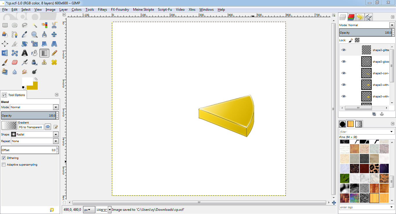

Glitter effect:
* New transparent layer "shape3-glitter".
* Path window: "shape3" -> Path to selection. "shape3-shrink" -> Subtract
from selection.
You have successfully created the third piece!

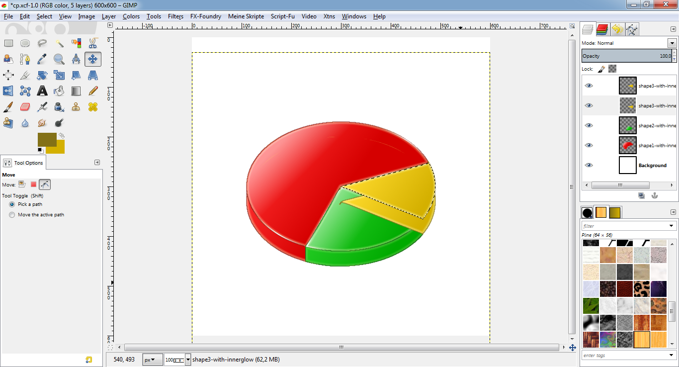

FINAL STEPS
* Unhide all 3 shape layers.
* Move the shape3 layer under shape2 layer.
* Move the shape2 layer a bit down and right.
* Move the shape3 layer a bit right and down.
DONE!
Congratulations, you have successfully completed the tutorial! Now it would
be a wise decision to save your work under a new name for later changes or
whatever.

 Post subject: Re: Glossy chart pie
PostPosted: Thu Jan 29, 2015 1:01 pm  (#4)
Very nice! :bigthup
PostPosted: Fri Jan 30, 2015 1:14 am  (#5)
Joined: Aug 30, 2012
Posts: 2174
Nice tutorial, this would make a nice script if you where able to enter the amount of segments and sizes.
